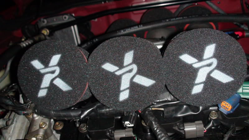

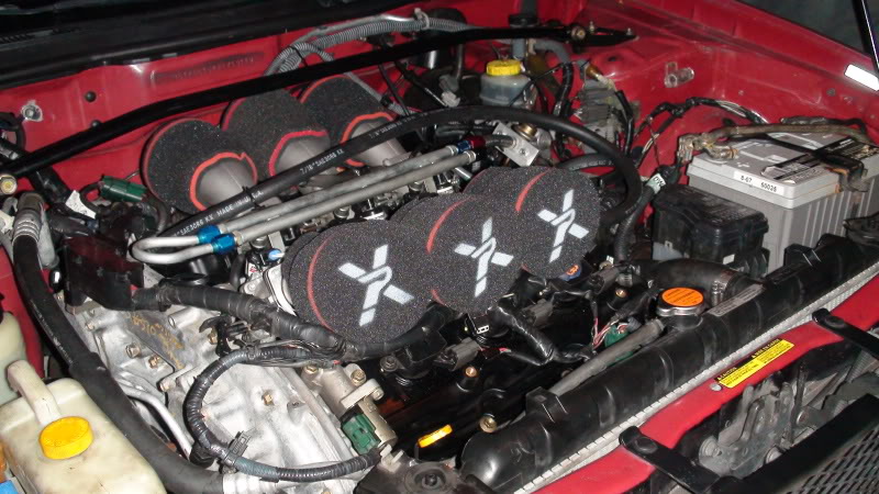

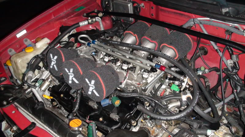

The Pipercross Trumpet Sock Filters came in so I decided to shoot a few pictures since I think it's pretty cool looking.

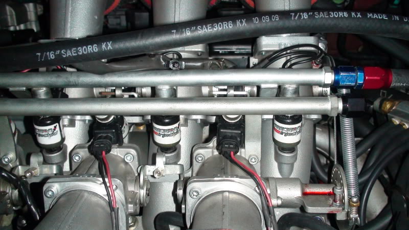

Here is a little close up of the fuel rail and injectors.

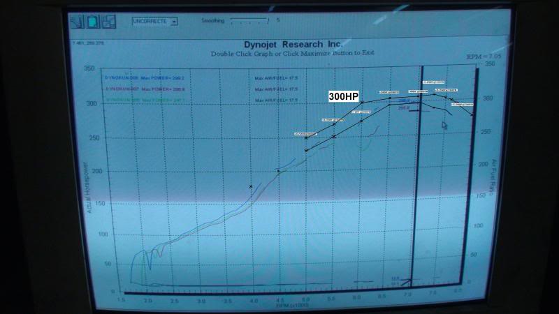

Alright if you see this graph you'll see how it works with me explaining the Xs.
@5000 +20-25WHP (1st X)
@5500 +20-25WHP (2nd X)
@6000 +25WHP (3rd X next to the big 300)
@6500 +20WHP (4th X)
@7000 +10WHP (5th X)
@7250 +35-40WHP (6th X)
@7500 +20-25WHP (7th X)
@7700 + 25-30WHP (8th X)
If you follow the Xs from left to right you'll see the gains.
The big 300HP mark is just showing where 300WHP starts from 6000-7700RPM is all about 300whp peaking at 315.
Keep in mind the tune isn't really complete because this was before any midrange tuning and the top end was just quickly made because the 9PM curfew for noise had to put a stop to the tuning that night and I took it home. I predict its got some more on the top end and you'll see even more under the curve later on too once they have time to tune it fully.
This graph is intended to show the before and after gains in the powerband for ITB vs stock intake setup.
Old Mar 30, 2010 | 10:36 PM
  #40
gabe3d's Avatar
gabe3d
Posts: 1,057
Likes: 6
From: san mateo
I finally understand your graph now! I've been wondering what the top dyno run connected to below 5k, but it's basically you plotting it based on your other video.
It's really interesting that both setup realizes max power at a very similar rpm and by looking at your previous manifold I noticed that it's a log style one. It seems that the entire power curve is just shifted upwards by 20-25whp, is that also true down low? I would have expected a more gradual increase in power as rpm climbs. Too bad you don't have a torque curve on there.
