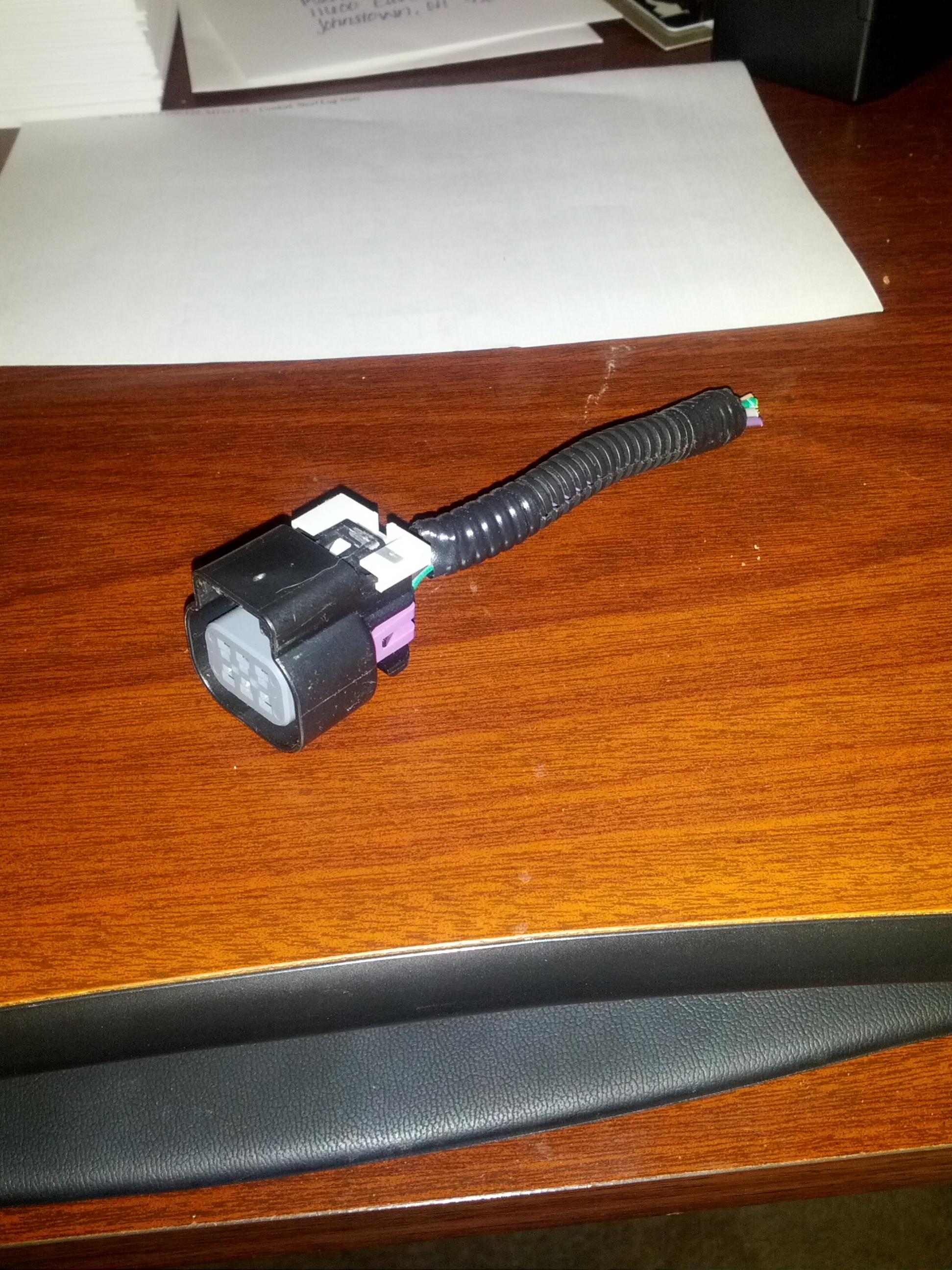

pics of the pigtail? where'd you get it from? seems that surratt made an adapter harness to go from stock TB to Max TB, he should be able to put the stock ECU end on your 87mm TB pigtail.
those caddy TB's are cheap on ebay. Have you tried connecting it to the stock ecu yet?

I think I got the pigtail from Rockauto actually. I have the wiring all written out and I will be splicing it myself. Yes they are cheap on ebay. That is where I got mine.
I have a race next weekend. After I get back from that I will get it all hooked up and give it the first attempt.

Here is a pic of the pigtail.

I Just got this at home...
Where can I find a pigtail like the one you got?

I think I got it from RockAuto. I honestly don't recall. I have the PN, but not accessible at the moment. I can post it later if you still need it. I may have posted in this thread already.

Pigtail PN: 88988106
Tanks!
