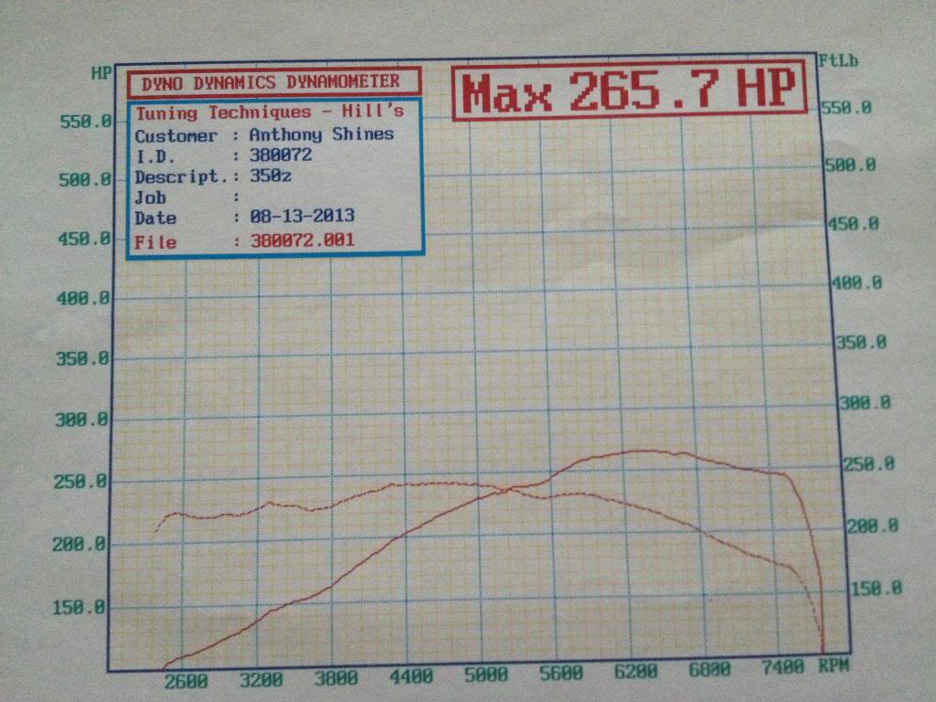

So after collecting all the bolt-ons I could, I finally got my car tuned and dynoed and I must say I am overall pleased with the numbers and the feel of the car. Its very responsive and has great low end power for what I plan on using the car for. So with out further ado, below is my mod list:
Engine modifications:
Engine mileage @123,XXX
Motordyne plenum spacer
Motordyne lower intake manifold
JWT Intake w/Z-tube heatwrapped
PPE longtube headers
AAM Y-Pipe
Fujitsubo Catback Exhaust
Lightened flywheel w/6puck Clutch
Moroso Oil catch can
Greddy Oil Cooler
Custom Upgraded p/s Cooler
Uprev Tune
Mishimoto lower temp thermostat
Mishimoto radiator hoses
Unfortunately I cant show a base hp without mods to the current power so i apologize in advance.
The car was also tuned prior to this recent tune and baselined at 265whp (installed PPE headers and MD lower intake manifold and spacer) made an additional 13whp for a total of 278whp.
Note: Car was dynoed on a Dyno Dynamics machine.
See Pics and video below.
Initial dyno.

top end looks good. maybe the headers killed your mid range torque.

Have you looked into a larger TB?

My crusty old 03 DE made 8whp and ~22wtq more on the same dyno. My car runs on ethanol, though.

Not really... Not sure if its going to benefit much.

Looks like some cams are next on your list

wonder if the revup lower plenum would have got rid of some of that top end dip... doesn't seem like the mrev + spacer did much for the midrange, unless the PPE headers cancelled out any low end gains... but that's just my speculation.

Top end got killed bc of MD plenum. I'd rather REV a REVUP engine out and extend the power curve.
My Cosworth and a few other intake mods (ITBs being one if them) are what shift or extend the power right.
I want to see what the Revup lower and 1/2" spacer do with the headers.
