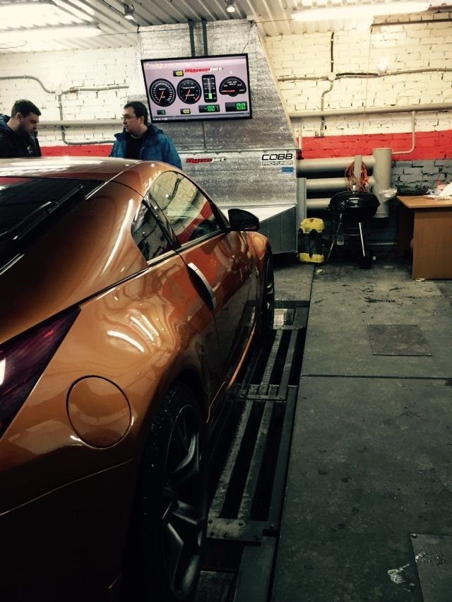

Here is my build.
1. Nissan 350z VQ35DE (mileage of engine around 15-20k miles), AT, R19 (rays 370z), 2003-2004 year.
2. Kelford 189-A camshaft Nissan VQ35 Gen1 (350Z) 264 Duration, 10.75mm.
3. Custom exhaust manifold.
4. Test-pipes Invidia.
Today i was on dyno and everyone was kinda suprised

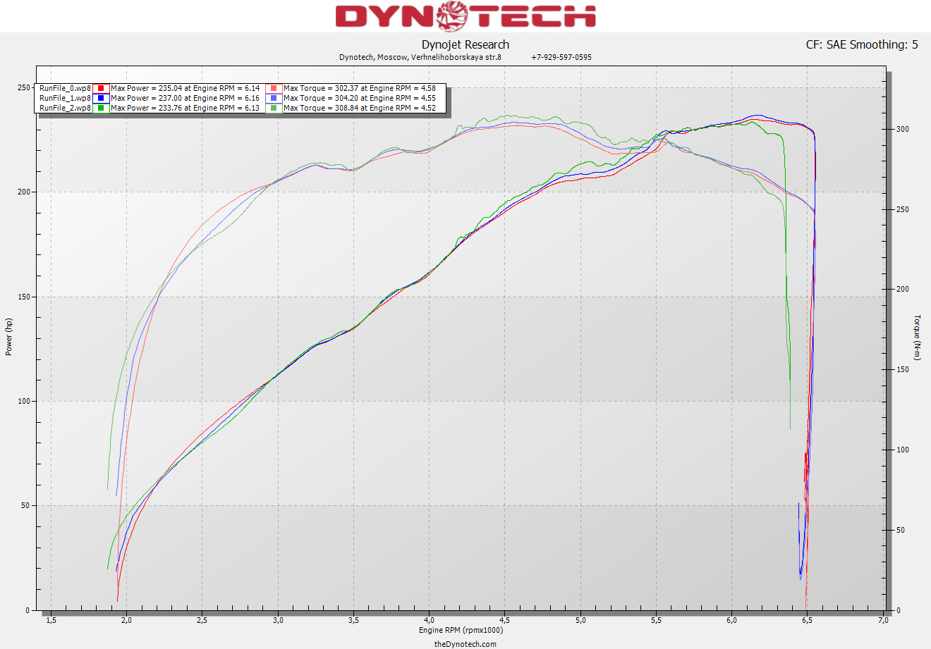

Here is my graphic.
350z
So we got almost 240 whp on 3rd gear on AT, thats not bad as i know
I'm focusing on 280 whp.
I would be glad if you tell whats better to replace next to increase whp/trq.

3rd gear pull? Shouldn't it be 4th for AT? I think that's why your TQ number is in the 300s. There's no way your TQ should be 300 and your HP be 250 on a NA build.

That is weird that your hp is so low and torque over 300.

His torque scale it's in nm not ft lbs.

226 Ftlbs

Sorry i forgot to tell.
3rd gear pull are only shown with red and blue color.
Green color is 4th gear pull.
Why my trq should not bee 300 nm?
Any advices on future specs?

Nope, all makes sense now. Didn't see the nm on the side of the graph.
The only think I would suggest is finishing the exhaust. Even though you've got a custom manifold and TPs, finishing out with good flowing exhaust system will be able to bring your TQ up a little. And that's a pretty decent TQ number for AT. So far I haven't really seen anyone over 245-250 TQ with AT on here with full bolt ons.
Also, what intake mods do you have besides cams? You'need to make sure you're supplying enough air in to take full advantage of the cams as well.
Look into those mods, and you should definitely be close to the 280 mark. I think once you allow more air in, and have it exist faster you'll see the cams really open the power up.
