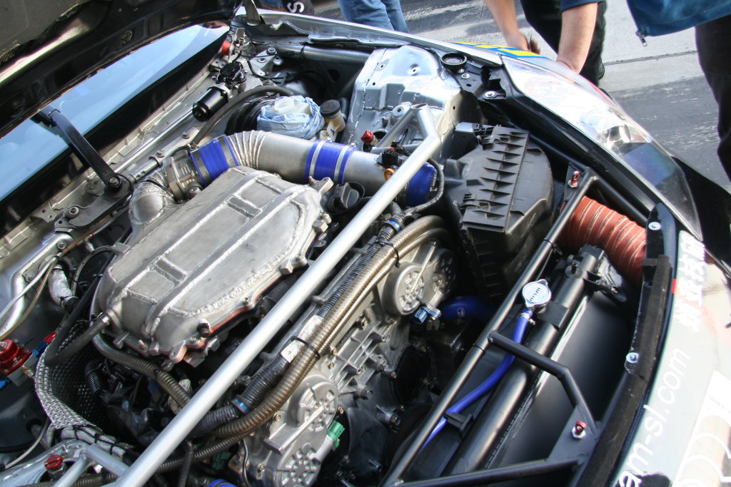

By the way any of you know anything about this??
Attached Thumbnails Upper plenum project 75mm Maxima TB-1224788636_boiteaaircourse.jpg
