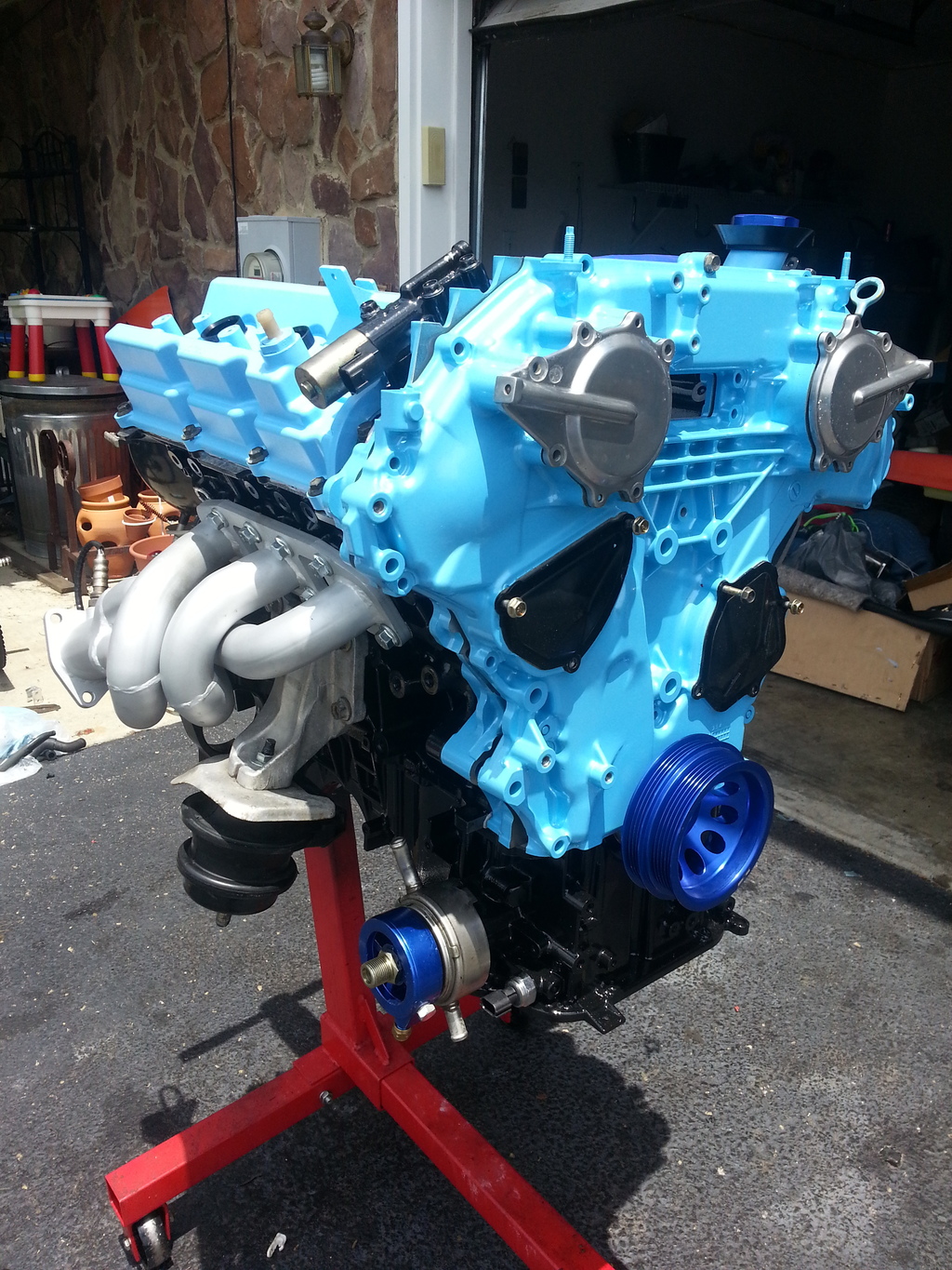

Yes i have looked on the forums and havent seen any possible solutions to my issue.
BACK STORY:
About 3 weeks ago i tried installing headers in my car with the engine in it. Many hours later i became so frustrated that i decided to pull the engine to ease the installation. I have had the engine out multiple times so its no big deal. But after seeing my motor out i decided i might as well build it. Forged rods, pistons, all gaskets, stage 2 clutch and chromoly light weight flywheel, headers, catless dual exhaust. Basically just getting ready to re-turbo my car. My past rear mount setup failed after a couple years so im about to buy a front mount kit and would feel better if i had forged internals.
ISSUE:
First start up, 5-30 with lucas additive. She turned over and idled at about 1200 with semi-normal oil pressure. I reset the pedals and monitored the parameters with my Osiris Uprev Cipher. Everthing checked out so i started the first drive to break it in. (after reading multiple threads on break in opinions i read, "do you trust the people that built the car or people on the internet", so ive decided to go with Nissans soft break in). The car drove like new! kept it under 4k and the thing is smooth as heck. except when i stop.. The idle dropped back down to normal at about 800rpm. At 800rpm the dash oil pressure guage was reading about ~5 (barely above 0). when i tap on the gas and get it to about 1000rpm the pressure goes up to 15. at 2k rpm the pressure is about 30 and so forward. I looked up what nissans spec is on the minimum oil pressure at idle and it shows 16. Not sure what these cars are supposed to idle at but i guess its around 800. So yes the oil pressure is a little low. Also i should mention this is only when the engine warms up. On a cold start it jumps to almost 90 and then lowers to 30 when i start to drive then after a short 5 mile drive its warm and the oil pressure will show low and the oil light will usually come on.
I have ordered a new pressure sensor and am hoping that is all the issue is. I replaced the sensor a few weeks prior to the tear down so its not likely though. I need to hook up a external oil pressure sensor to ensure this though. I just wanted to quickly get on the forums to see if i should not be driving this low oil pressure.
Not sure what could be causing it, hopefully not a bearing out of clearance spec. I hit 100 miles today and am probably going to change the oil in the morning. Opinions on 10-30? too thick of oil for a new motor? i have read that this should increase the oil pressure.
Sorry for writing a book, im at work and am getting paid so i figured might as well not leave anything out!

Speednz, there have been others here over the years with exactly this problem. The cause was a small internal oil leak from a misplaced or damaged gasket at the front timing cover. A bad pressure sender doesn't act in this manner. Right now I'm in a restaurant in Dubrovnik with just a tiny scrap of wifi so I can't look up any links for you, but if you google around you will find so info on VQ engine internal oil leaks

Have you checked the pressure with a known mechanical gauge?
What are your bearing clearances, Rods/Mains? Your built motor could/should be a little loose vs stock, if built for higher HP.
As Op stated, there are places inside that can leak, post oil pump.

Thank you!! I searched and was not able to find the thread mentioned. Was it on here or the "other" forum. Im assuming you mean one of the small orings could be the culprit? unfortunately i dont think its a faulty sensor and it may be a internal oil leak. But the car is not leaking any fluids nor does it smoke any at all under any circumstances. But would this explain the pressure being normal at cold temperatures then significantly dropping when the engine warms up? ( i know this is normal but to this extent)
i-break-things,
Im going to plug a mechanical guage up to it tomorrow. Hopefully i wont have to take my front timing cover off as i believe i may have stripped one of the bolts in the center. Did i just say that out loud?

The oil could be leaking, internally, as op stated. It's easy to pinch an o-ring. Maybe not so easy to replace, location, location, location...
If you have more bearing clearance than factory, fully you do, you could have lower pressure as well.
What oil pump are you running?
Do you know the width of the pump gear?

Jennifer and I break things, unfortunately this is what I believe may be the problem. The o-rings I installed seemed slightly smaller than the ones I took out. That's probably where my oil pressure is sliding out at. Guess If the mechanical guage I plug up reads low I'll be taking my timing cover off. Lots of fun that will be.. And ibreakthings, the car only has 70k, so I didn't replace the oil pump.. I would have if I had $200 laying around for an oem but I didn't. I didn't remove the crank but I did spec the rod bearings to Nissans recommended clearance. Not trying to build a race machine I just wanted forged Internals to ease my mind. Thanks everybody for the responses!
