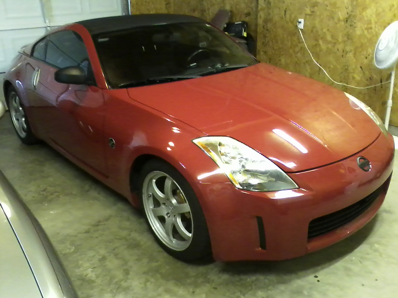

cant post a pic to save my GD life. Torrid red, stock but for a borla exhust.

Here is a pic. Changed to redline synthetic gear oil right after purchase with no effect. Talking to my mechanic about a leakdown test. Some jackass pulled out in front of me today and I stood this thing on its nose. No complaints about the brakes!
