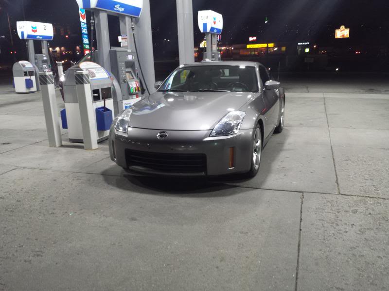

Hey fellow Z owners. My name is Brashen and I just got my first 350Z tonight and so far I love it. It's a 2007 Carbon Silver Nissan 350Z Touring.
I am the 2nd owner of the car and I picked it up with 52000 miles.
Here's a pic of the actual car.
(Sorry for the crappy cell phone pic...)
It does, however, have an issue with going into 5th. It doesn't grind, just pretty difficult to put into gear.
If anyone has any info on the issue it would be greatly appreciated.
