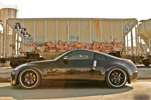

So bought my first 350z.
Car sat for 2 years so now i'm trying to work all the bug outs it from sitting..
