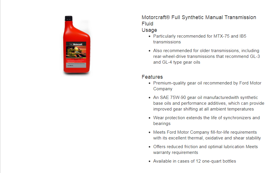

Im sorry, i meant ford motorcraft full synthetic, view image for more details.

Ford motocraft fluid works better than the redline, redline was great when i ran it, but especially on cold mornings the transmission seemed to still be a little stiff, and made a slight whine in 1st gear until it warmed up after a couple of minutes, when i switched to ford motorcraft the slight whine went away, and worked really well even in cold or extremely high temperatures. You also will see that this is a highly recommended fluid on miata forums as well. It makes shifting way smoother, like a dream come true if you will.
