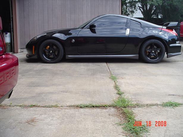

i went with a different wheel 95 cobra r 17x9 with faulken aziens 615 270/40.
mostly for tire rotation and a different look. when i push the car around a turn the front end pushes a little.cost 140 per tire and not a lot of drop of in performance unless you push hard in the corners.thats my 2 cents.
