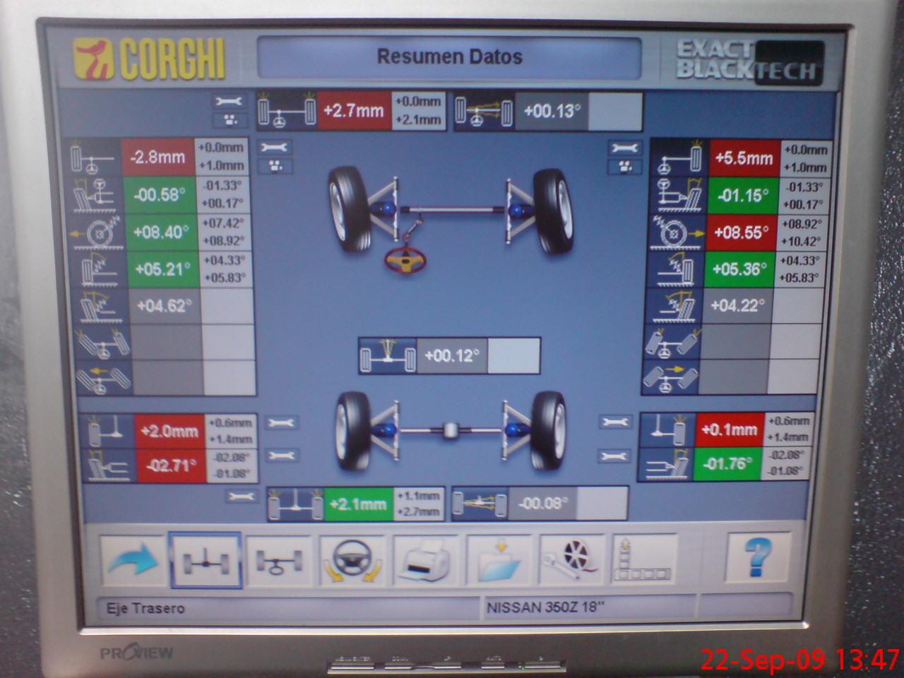

I did mine after 1 1/2 year since I got my NISMO with me. Thanks to SOLO-350z, it reminded me to check the alignments on my NISMO.
This is before the alignments. Now everything is correct after the alignments. Thanks SOLO-350z.
