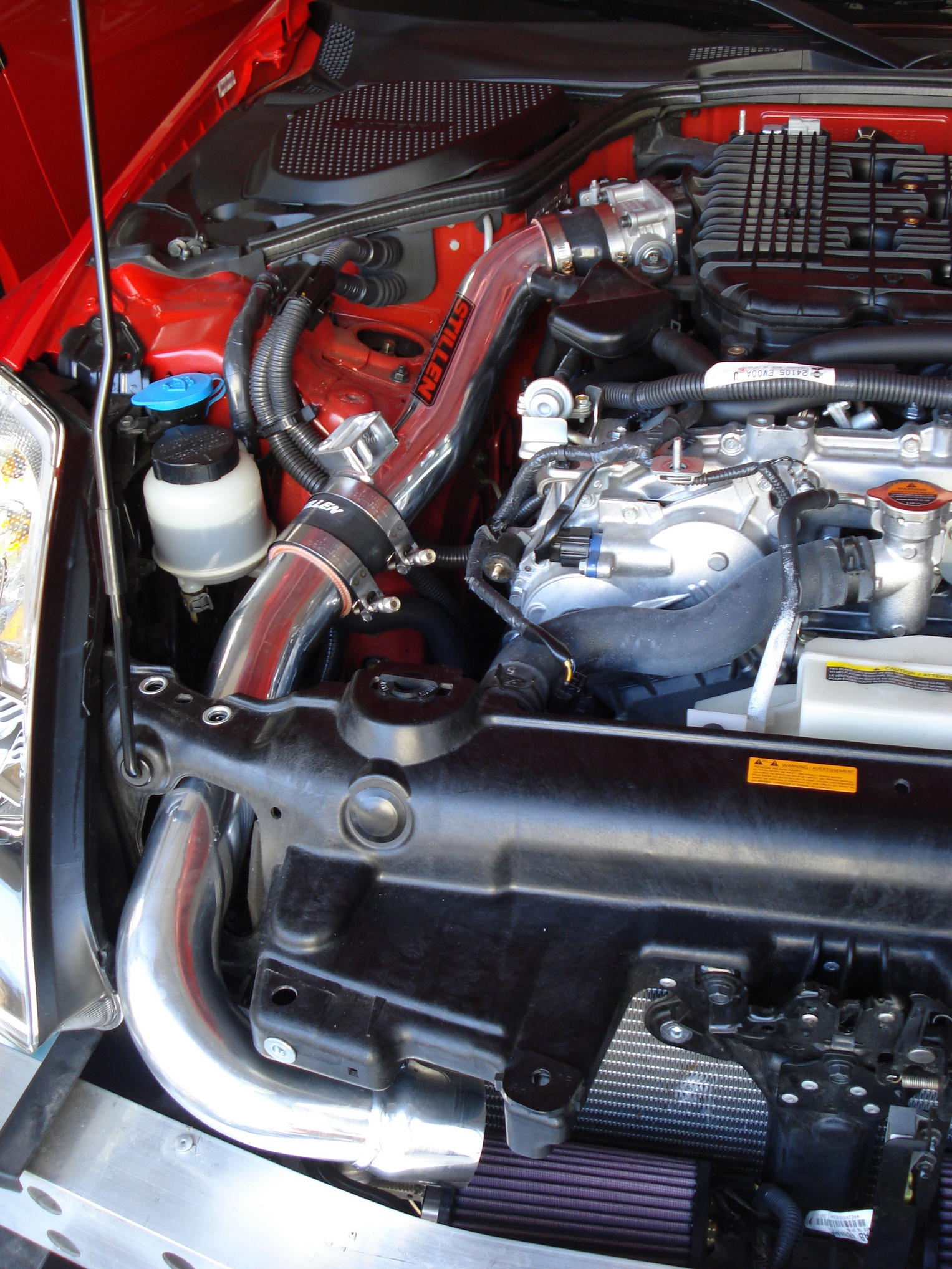

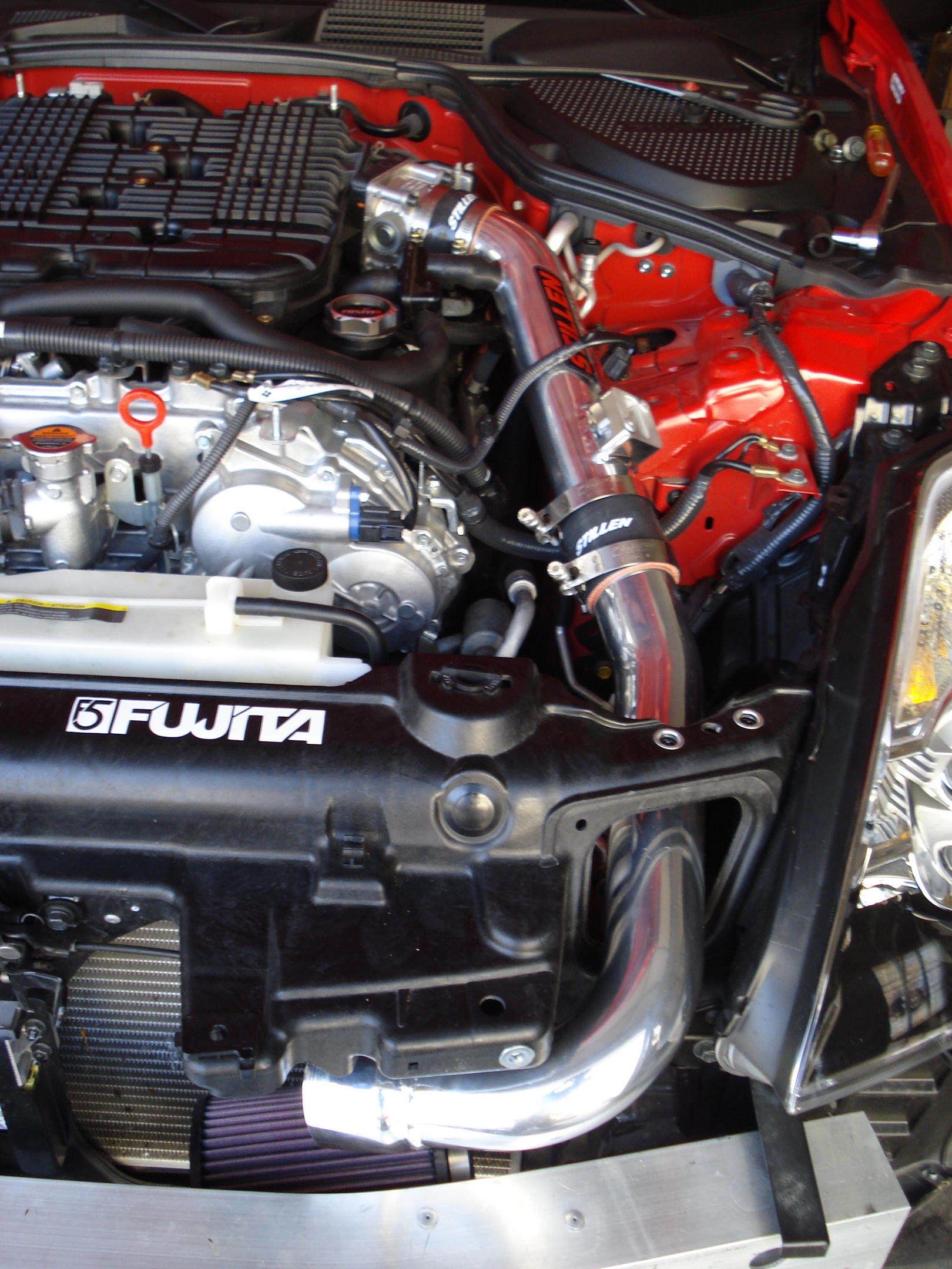

The Stillen site states "Installation Requires Mild Enlarging of Core Support
CARB Pending, DOES Fit NISMO 350Z, (Oil or Trans Cooler Req Custom Mod)." Did you have to modify anything major to get these to fit? Any pictures? Any concerns of getting the filters wet when driving in the rain?

Brick, I did not have to trim anything. The inner layer of the intake support comes out with a few screws with the stock intake. The tubes fit in with a good amount of room to move it around. I am not concerned with water because lookin at it, it sits high enough where water will not really reach that spot unles its comin down horizontally by an act of God straight into the grill opening. The only thing i had to do was move the horns further down and screw them into the core support. took like 10 minutes to do that. It was a great experience and it was worth it. Ill put the best pics that I have of it up.

The Nismo vehicles do not require the same trimming that a non-Nismo edition does..
