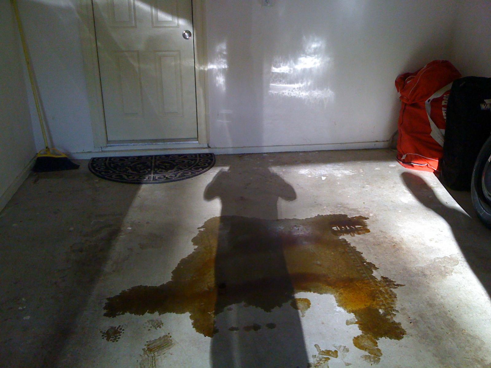

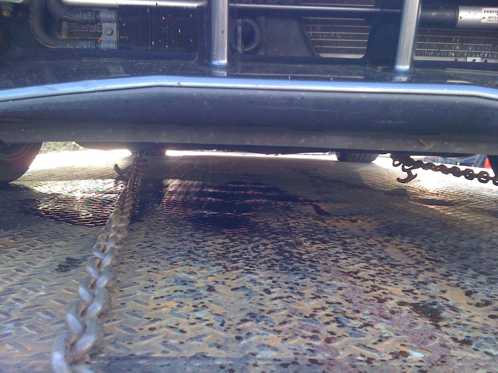

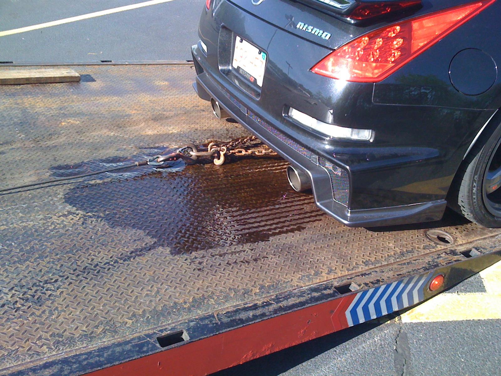

HOw about..........
you jack your car up, and look to see if you have a drain plug??
but my guess is that when they swapped the oil filter........the old rubber oil filter ring stayed stuck to the car and when they put on the new oil filter they didn't notice.......
I HAVE SEEN THIS HAPPEN!
thats why you were able to drive and didn't loose all your oil all at once and your gauge was slow at noticing..........more than likely thats what happened....
its worth your time to do so........if you find the issue, before they do, take pictures and arm yourself with data!....
if you dont have time or a jack to jack the car up and look, slip the tow truck company driver 20 bucks and ask him to do it, they usually carry a jack with them....
if not, dont let your car out of your site at the dealership.......take pics!
the dealership isnt gonna be so "WILLING" to get you a new engine...pfffff!
