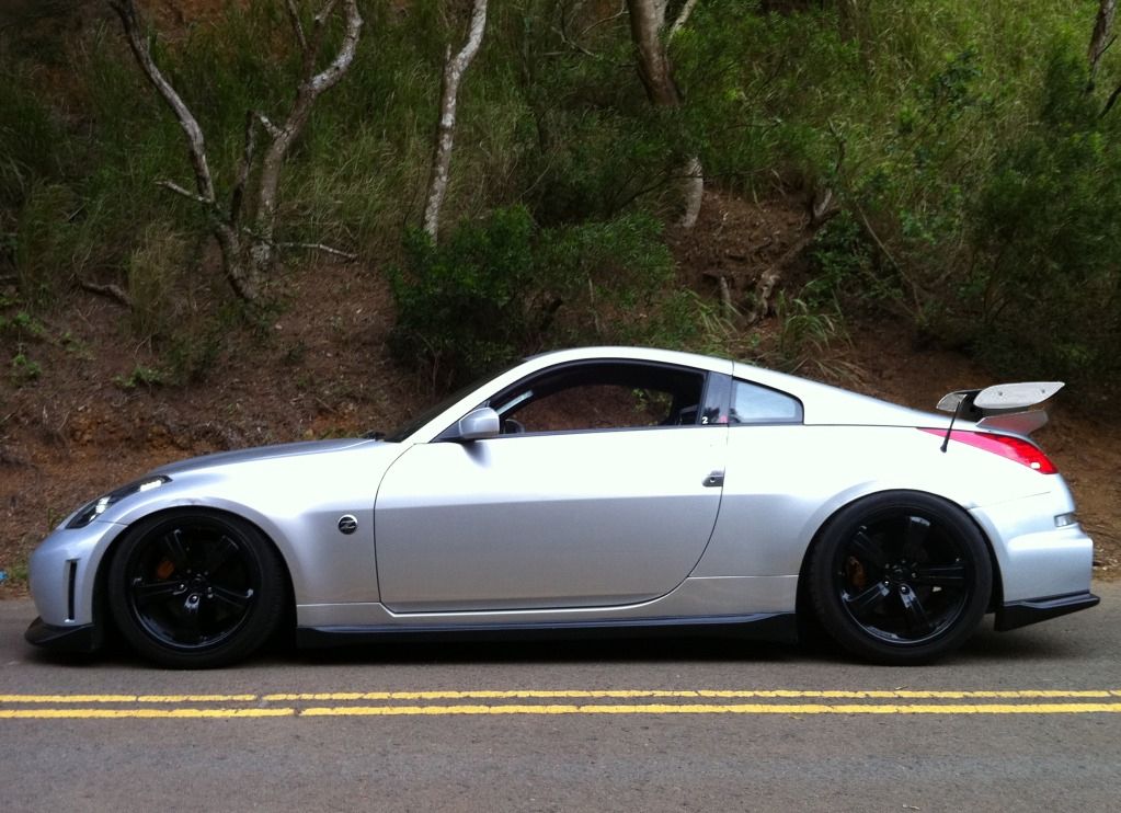

Originally Posted by Sean S
here you go, no problem:

^nice ride King. looks like you rub like crazy. what size rear tires?

That's an overstatement, thanks! It's my pile of poo first car...
The rears are 285/35R19 Falken 452 which where purchased used to see if they fit. They don't lmao. It requires a lot to fit them, they don't rub now. The rear fender well has been cut open and trimmed of anything that would make contact with the wheel in full compression. Even the rear bumper arch has been trimmed and the tabs relocated backwards some. A few members in the fat tire thread are running similar and one member even went to 305 at my ride height which is nuts!
The fronts still rub on turns, I'm in the process of increasing the rear arch of the front fenders. If you can picture that, you'd understand why. The 350Z and even worse 370Z has huge side wall if you would to it's fenders! So at full lock the fist thing the wheel will contact is that lip. Elevation changes do not help this fact, in the drift world this is a easy fix! Enlarging the fender arch so that at full lock the fender isn't a henderance!
I don't drift long exchanges or switch back, but the mountain runs here have huge elevation changes 10-20ft drops on hairpins!
I'm looking at SP1s right now to achieve the offset I have right now without spacers!

king it looks like your building your car for track use. dont lowered z handle horrible when lowered too much?

Yes when lowered too much!
When I initally lowered my car it was all by eye, after many trips to mexico. I've since then raised my car .5" in the front, and 1" in the rear. Also played with the dampner settings on my Korean coils(Stance). Many will call these coils "crap" yet when used I'd like to say correctly they're alright. Only set back right now that I have was my front tires where Nexxens...very cold/low grip tires...which are great for DD becuase even after all the abuse I put on them. When I dismounted them, the wear was even and still useable tires! CRAZY!
I have new tires in my kitchen next to the rest of my pending car
All this is butt garage talk cause all I have to compare this to is other Z/G/Subaru/Evo/maitia and their drivers. I don't AutoX cause the speed limit on those events to me prove only that the car is nimble tight turn for tight turn. No road course type corners, which I rather.
