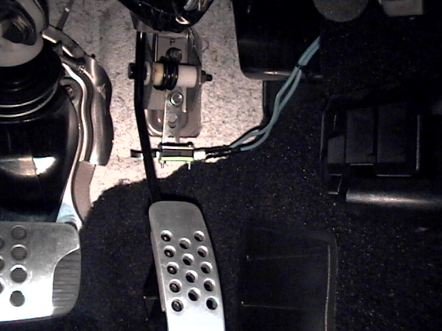

Sorry for being such a newb at NOS discussions but what exactly is the WOT switch for. Is that like a safety switch to have NOS engaged and disengaged when racing?

it is for safety and its not as complicated as it sounds. WOT stands for wide open throttle. all it is, is a trigger switch that you install right behind your gas pedal. you set it up in a way where its activated only when your gas pedal is floored and just barely activates the switch. this way the nitrous system will only activate when your at full throttle which keeps your engine happy. its a cheap $5 part, but its a must.
