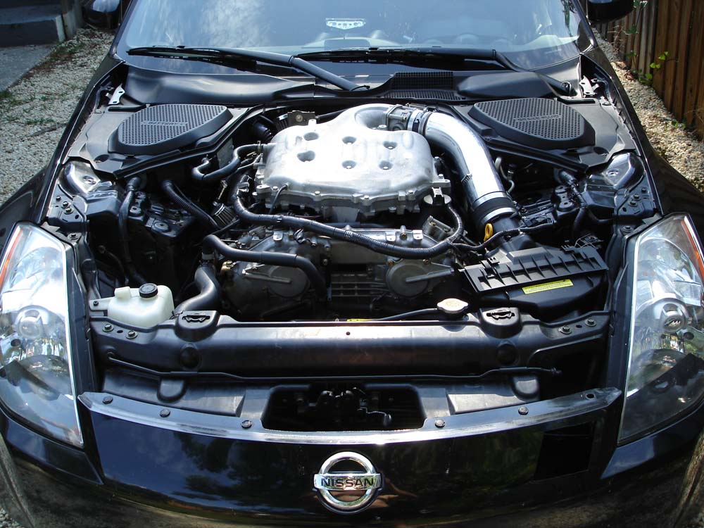

Originally Posted by killerlexus
so you can use this to turn on and off at FULL THROTTLE or do you still need to mount a switch behind the gas pedal?
where would you tap in to for a signal? from CPU under passenger side or from the distributor? sorry dont want to noob it and be a statistic.
Unfortunately for saying something so dumb your a newb Find the distributor on our Z's and take a pic then post it up

From: United States
alberto, youre such a noob..... mine is right there!!!

LOL, yeah I see it now...its behind the hole in your bumper

why do you think its soo easy to advance my timing, i just turn it counter clockwise....
