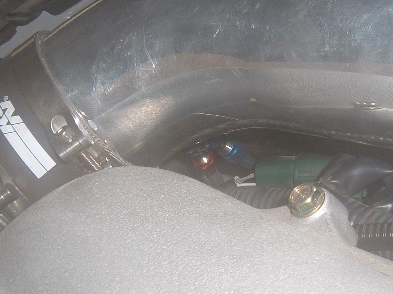

Tried to take a picture so you could see the nozzle. Here she is...
Attached Thumbnails Install complete!-entire-engine.jpg   Install complete!-fuel-tap.jpg   Install complete!-fuel-solenoid.jpg   Install complete!-nozzle.jpg   Install complete!-nitrous-purge.jpg

Originally Posted by MySunset350Z
looks good.
you might want to think about adjusting the siphon inside your bottle because of the way you have it setup. you might have problems with your system being jumpy when the bottle gets to about 25% full.
no heater?
Heater??? I'm in texas...a heater would probably cool it down with the temps we get here.
We'll see once I get down to the end of the bottle. Sometime's its ok.
