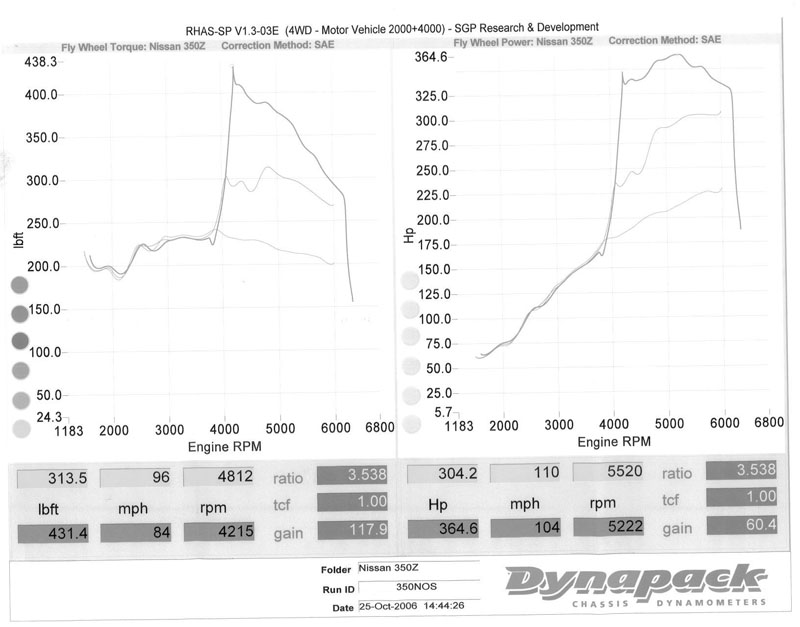

Old School's Avatar
Old School
Shift_Boost
iTrader: (28)
Posts: 10,740
Likes: 25
From: On a forum dedicated to Boost
here's my dyno for all motor (i/h/e/spacer/utec), then a 75 shot, then a 150 shot. 100 shot will put you in the 12s...125-150 will put you in the 11s, but you'll need a better 60ft. 2.1 just doesn't cut it and the Z is more difficult to get to hook than your old evo.
