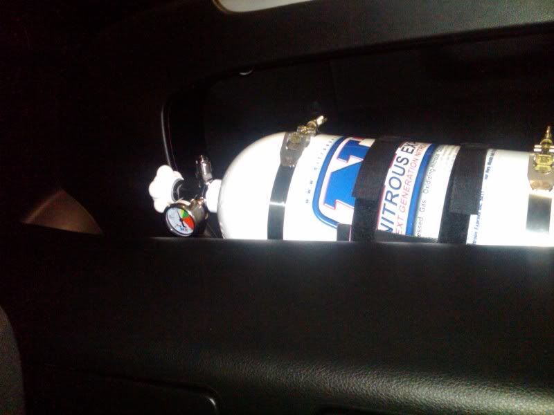

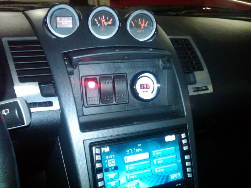

Shearing the progress I mad on my nitrous install so far. I don’t have much time to work on the Z car as I have a few other projects I have to complete for the upcoming race season. Hopefully this Saturday I will have the time to finish it up. Anyway my setup is as follows.
NX EFI kit
NX switch center
NX liquid filled N20 pressure gauge
NX bottle warmer
NX blow down
Low fuel pressure switch
Dyno tune purge kit (got it for free)
Dyno tune fuel rail fitting
UTEC with map switch (still waiting for MAP switch to show up)
AEM UGEO wideband
N2MB WOT BOX /Nitrous controller
When all said and done I plan to run up to 150 shot with some race fuel stock motor. But for now im starting off with 100 shot lean to drive with the nitrous them up the anti later down the line. The install is pretty simple just a lot of routing wires, soldiering etc. Plan was to play with the z this summer and take some dime off the other car but plans have changed. Will keep updating this thread whenever I get more work done. Excuse the filthy car it has bin sitting in the shop for a while just collecting dust.

Is that an ideal place to mount the bottle? I know instruction say to mount the bottle facing towards the front of the car to maximize the feed line in the bottle. I mounted the bottle the same as you did in a previous car and had issues because of it. In a z there arent too many options though

You don't want to install the bottle in that orientation, but as you said, we don't have much room to work with.
What problem did you have with bottle installed in that formation? Buddy of mine has the bottle mounted the same way in his mustang with no problems. That’s the most secure place i could come up with to mount it in the Z. I want it to be easily accessible so i can pull it out and put it back with no fuss.

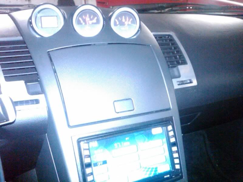

is that your switch center above your gauge? i only see three switches, the dynotune center has 4 (arming, purge, opener, heater) what are you missing? also, what tuning are you doing for the 100?
Yes it is, has 4 switches just like the dyno tune unit at half the price. The first switch is a 3 way switch, down is heater, up is armed and middle is off (neutral). Works perfect

so you cant have the heater on when armed? any tuning done?

I wired it so i can have the heater on when the system is armed as well as unarmed. haven't done any tuning yet just tested it on a 75 shot. I ordered bigger jets that should show up this weekend i think.
