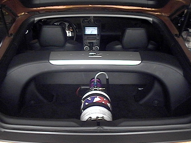

Originally posted by MySunset350Z
how did you mount the bottle like that? Isn't that just being on the board on top of the spare and if so how do you pass tech at the track?
Otherwise I like that location
