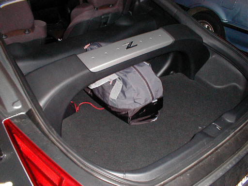

NX Wet Kit 75 shot (41/24)
NX Bottle Opener
Zex Heater (P.O.S.)
Zex Gauge
Zex Purge
NGK 1 step colder plugs
I've had the system for about 3 months. No serious problems. Been hella lagging on the dyno, haven't had the time or funds. Pretty happy with the power but I'm thinking about going to a 100 shot and stopping there. I want to dyno what I have first and see how I'm doing. I also want to clear up some jet size confusion with NX first.

Nice setup cyber... The gymbag in the trunk is always funny to me.

Hey dude, by the way is your bottle inside that Gym Bag??? Or is it in the spare tire hole. That bag thing is a good idea.

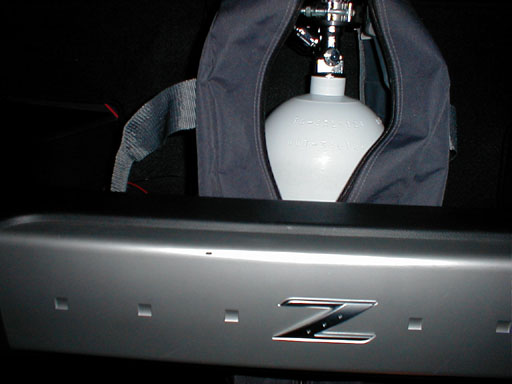

Uhh...is there a problem officer? I'm just on my way to the gym.

I like the gym bag idea. Very clever and stealth
