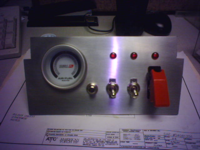

well, being the picky guy i am i decided to make a custom switch control panel for my nitrous as well as have it house my a/f gauge. i made it from aluminum, then brushed it by hand with steel wool to get the brushed look to match the interior. i then silicon sprayed it to keep it from tarnishing & resist fingerprints. im pretty happy with the final results. here is the finished product on my desk at work:
-justin

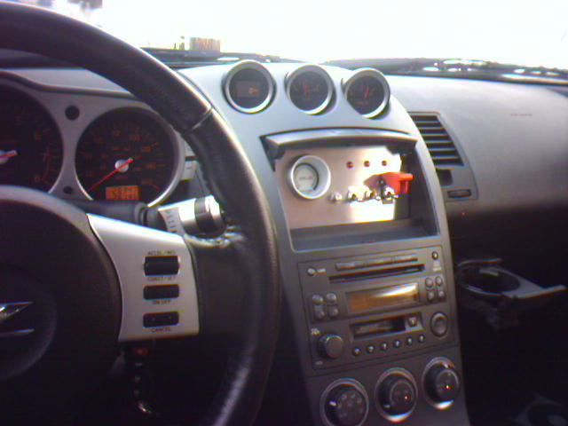

heres one of it installed in my dash where the navigation system usually goes: (sorry about the pic quality, this is the camera attached to my cell ph.)

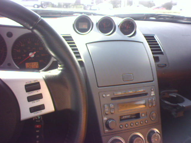

this pic just shows how it blends in nicely with its surroundings

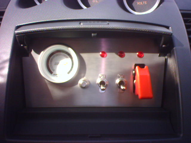

last one just shows how it can all behidden with no evidence of nitrous or aftermarket accessories
