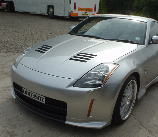

I know that mine were not water jet cut for sure...
The issue with water jet cutting an ali hood is that it is a composite structure with the underbraces and the top surface, so the material is not supported evenly across the whole area. Might be worth checking that they have considered this
Nice ride~ I already check with the engineer about the support frame underneath the aluminum top surface. He said the waterjet can cut through 10cm of solid metal, so I don't think the thin metal support underneath the top surface will matter...
It's not the fact that the waterjet won't cut through, but the fact that the pieces in the top surface of the hood (if you cut from top down) are not supported whilst cutting... so the force of the cutting jet can flex the aluminum skin down with sheer force. This wouldn't happen on a SOLID block, hence why he can cut through 10cm thick material.
