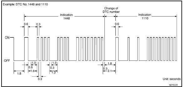

Here are some diagrams that might help out. These were taken directly from the service manual. The first is an example of how to interpret the flashes of the CES light and map them to DTC codes.

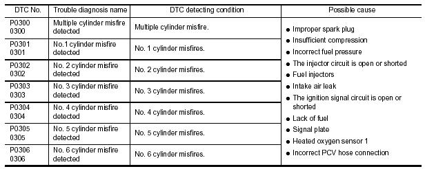

The second is the description of DTC 0300 - 0306 from the troubleshooting section of the service manual. I'm not convinced that his code is in fact 0300. If it is, however, a rapid change in the crankshaft speed sensor is what would generate 0300 specifically, so it could be any of the possible causes listed.
