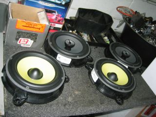

here's a pic of how my installer mounted the focal speakers in the front and rear quarter panel.
They cut out the stock speakers from their baffles and used those to mount the focals.
the 165kp have a 85 mm (3.33") magnet
pictures are worth 1000 words...
note: i drive a g35 coupe...so the door space behind the panel may be a little bit different.

2004Z : Custom Audio in Mountain View. Come down on Tuesdays afternoon around 3-4 pm and you'll see me hanging around the shop. It's a mom and pop shop, nothing like those big name places such as Sound Innovations. I could introduce you to the owner and try to get you a decent deal. They are an authorized Focal /Memphis/Pioneer/JVC dealer. I have a Memphis 16-MC3004 amp running my speakers. I'm running the 165CV in the rear quarter panel. PM me if you want details.
Neurosis: I know you said you used the Clarion baskets..I was hoping the picture would help you. Maybe you had them mounted differently.

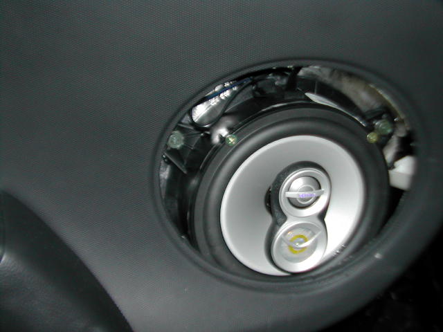

Here is a picture of my setup

I did the same as sal1 but had trouble getting the grill to fit back on perfect.
