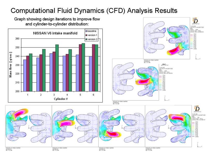

anyone see this on the cosworth usa site?:

http://www.cosworthusa.com/store/pc/...2&idproduct=89

I wonder if the flow data is for steady state or pulsed flow. With or without heads?
The flow data shows stock intake runner #3 as having the highest flow rate on the stock manifold.
...Isn't cylinder #3 usually the first to go in FI applications?
EDIT:
Also note the same basic flow rate trends are practically paralleled in the different versions of the Cosworth plenum.
The paralleling trends may have something to due with the stock heads?
Interesting. I don't know what it means, but it seems the data is trying to suggest something about the differences in cylinder head flow rates.

Originally Posted by Hydrazine
+1 interesting to see.
Also note, The flow data shows stock intake runner #3 as having the highest flow rate on the stock manifold.
Relooking at that chart #5 is having the highest but #3 & #5 are very close. As far as which one goes first... No idea. But I strongly beleive in its about the tune and amount of boost you run.
Baseline (I assume stock?) in blue is showing #3 as highest. But oh well. Its just triva compared to real dyno results.

yeah but it shows a high level of R&D
better than the R&D data provited about the ssv

Oh I wasn't belittling the Cosworth analysis. Its excellent.
Its like something right out of a Boeing engineering department.
I was referring to Roberts and my discussion as trivia. At least that was what I intended to convey.

Well, I might be wrong here, but doesn't the bar graph indicate that besides the improved flow the difference between best and worst cylinder has grown far over stock (5 g/sec vs 10 g/sec approx) - is this "ok"?
It is more deleterious to have one cylinder lean (baseline) rather than one cylinder rich (version 2) since the overall A/F ratio will more closely approximate the five "leaner" cylinders in version 2, resulting in more fuel specified by the tuner.

Those cylinder numbers don't match the configuration I'm used to.
Says 1-2-3 are on one bank, 4-5-6 are on another bank.
