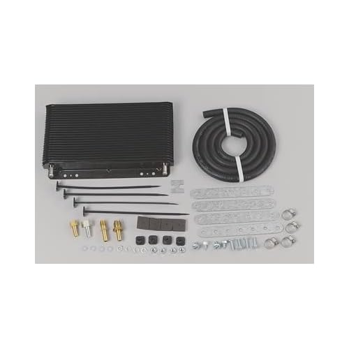

At ZdayZ I hit transmission temps of 290 deg F while driving with the Mad Scientist in the car, trying to keep up with Sharif's GTR. Completely unacceptable - had to shut it down. I realized later that that may be falsely elevated due to my temp sensor being located before the cooler (right after the torque converter) rather than in the transmission pan or after the cooler. I was very concerned that my current trans cooler was not up to the task.
So I updated my trans cooler from this:
B&M BMM-70264: Fluid Cooler, Transmission, Plate-Type, Aluminum, Black, 6 in. x 11 in. x 1 1/2 in, rated 14,400 GVW
to this:
Tru Cool 4590 - 48 plates, rated at 28,000 GVW and measures 11"x11"x.1.5".
Temps have dropped an average of 40 degrees F! Daily boosting keeps temp well under 190 F. Nice! I HIGHLY recommend this specific trans cooler to all FI 5AT owners. You can get it to fit snugly on the passenger side in front of the radiator. It covers the entire passenger side of the radiator and it's a tight fit, but it fits!
