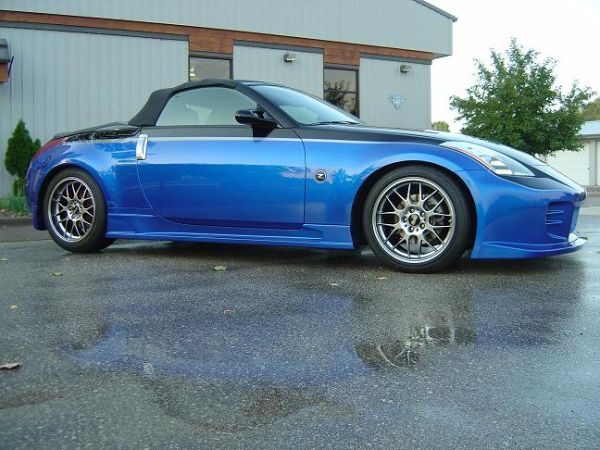

Originally Posted by Ryan@Forged
Mark's car upon arrival: (sorry for the closeups, I foolishly forgot to take good pictures from a distance upon arrival)
Ryan, at the risk of generating more paint job comments by Mr. De La Money and the crew, here's the pictures you didn't get. Thanks for making this build happen!
