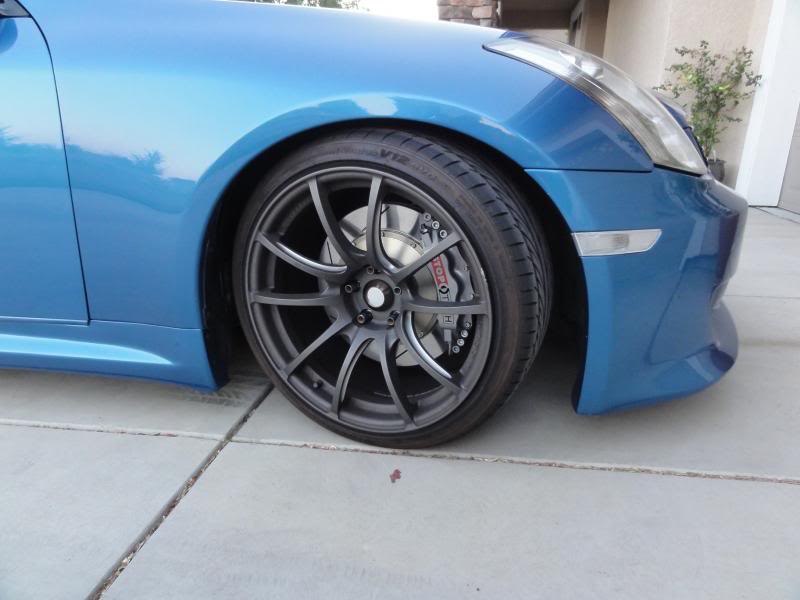

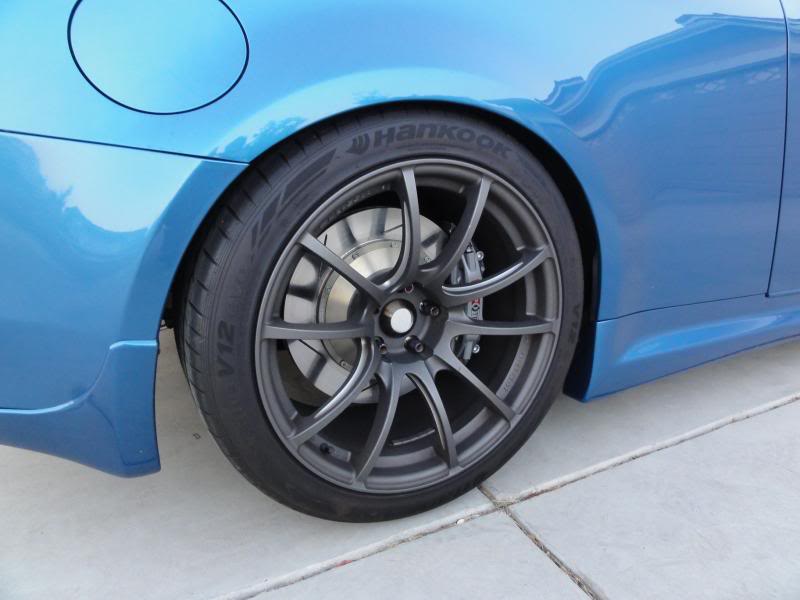

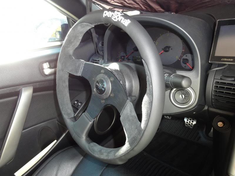

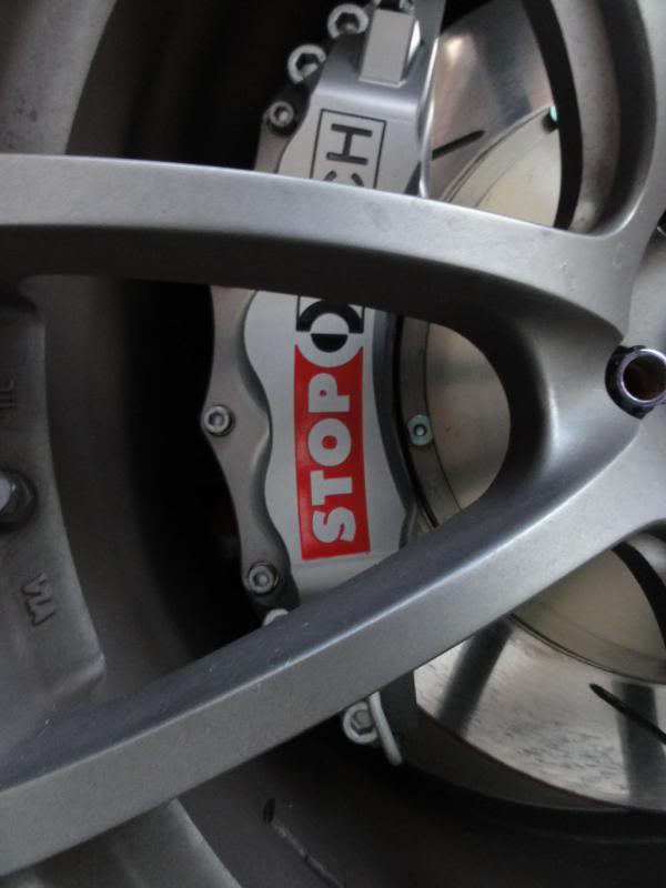

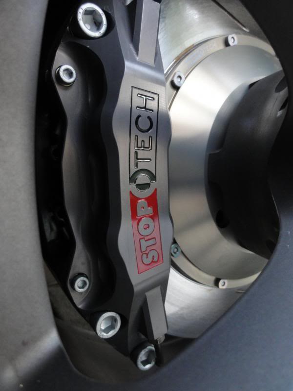

Came back from Korea last week and picked up my car from Zcar garage. Got a few misc things done before we tackle the performance aspect of things.
-Installed Personal steering wheel with WB quick release - grip feels nice and the slightly smaller diameter needs some getting used to.
-Installed Stoptech Trophy BBK on all four corners - tested them around the road and the feel is much more linear with less initial grab compared to the OE brembo and you can't beat the looks.
-Replaced the Mishimoto radiator with Koyo 36mm radiator - eventhough they were the same thickness the Koyo kept my water temp lower then Mishimoto, at around 210 max vs 225.
-Replaced the GTM TP with Berk HFCs - car is much quieter with less rasp and drone. Doesn't seem to have affected power much or any at all.
-Replaced SPL solid diff bushing with Whiteline poly bushing - this was a great decision for a weekend car. I like the SPL but the whining noise on decel was annoying me. This got rid of all those unwanted NVH.
-Replaced the OEM TC bushing with Whilteline poly bushing - didn't know I needed to replace these until zcar installed the BBK. I use to have this strange vibration while going down hill and turning right aggresively. I initially thought it was an alignment issue but this got rid of that.
-Replaced the OEM exhaust hangers - One of my exhaust tips was higher than the other side and touching my bumper. This fixed the issue.
-Replaced the OEM rack/pinion steering bushing with Energy poly bushing - Not sure whether it was the steering wheel, these bushing or both that change the feel but there is definitely more feedback coming from the ground to your hands. Something I also need to get used to, but so far I'm neutral about the feeling.
-Installed JWT oil spacer - this extra qt of oil in the pan made a big difference for temperature. Temp stays well below 215F vs 230F.
-Installed Cosworth Oil Baffle - can't say much about this. I decided to get this since it was cheap and the oil pan was out.
-Installed the RJM clutch pedal bracket version2 - great modification when the car is warmed up. On cold start the engagement point is extremely low and short, after running the car for 5-10 minutes things are much better compared to stock.
