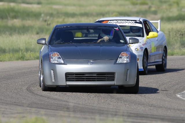

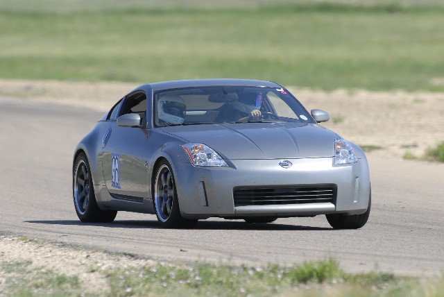

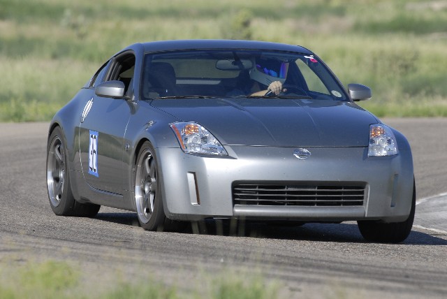

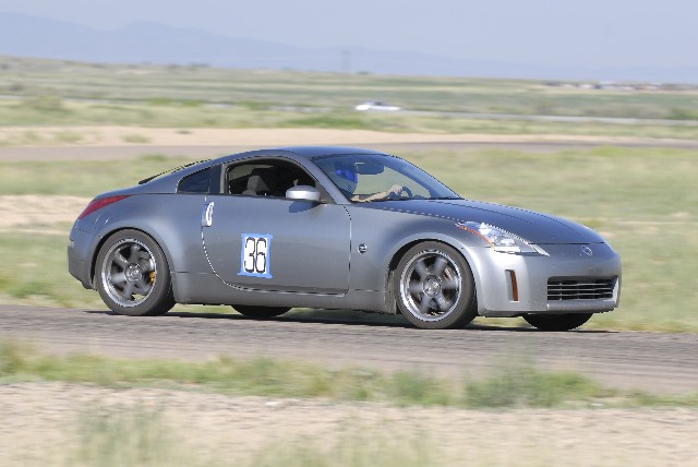

Yes, I was #36. I had a great time; it was fun being out there with so many other types of cars, and the open passing in group 4 was not nearly as hair-raising as I had been worried that it might be.
The only downer for me was that I started with my tire pressures a bit too low in session 3, and as a result the car was just wallowing around for those laps. I also found in some of the other sessions that I've come upon the limits of my springs/shocks (Nismo S-Tune), and I'm going to be looking to upgrade those soon.
As always, Pueblo was a fun track to drive, and while it was warm, I'll agree that it didn't feel nearly as hot as I had been afraid that it might.
I didn't get a chance to talk to the other 350Z driver…every time I went over there, he wasn't around. That car looked good on track, though, from what I was able to see.
What were you driving, Barry? I'm sure I saw your car out there.

OK; I remember admiring your wheels when I was watching for a while from outside of turn 7. What kind are those?

Those wheels are Volk LE-37T, 18 * 8.5 +22 in the front, and 18 * 9.5 +22 in the back, running Avon's Tech M500 street tire.
I thought about going with the SSR Comps, but they didn't make them in quite the exact size I wanted, and I've had friends bend them a little easier than I'd like to see on a wheel that expensive.
