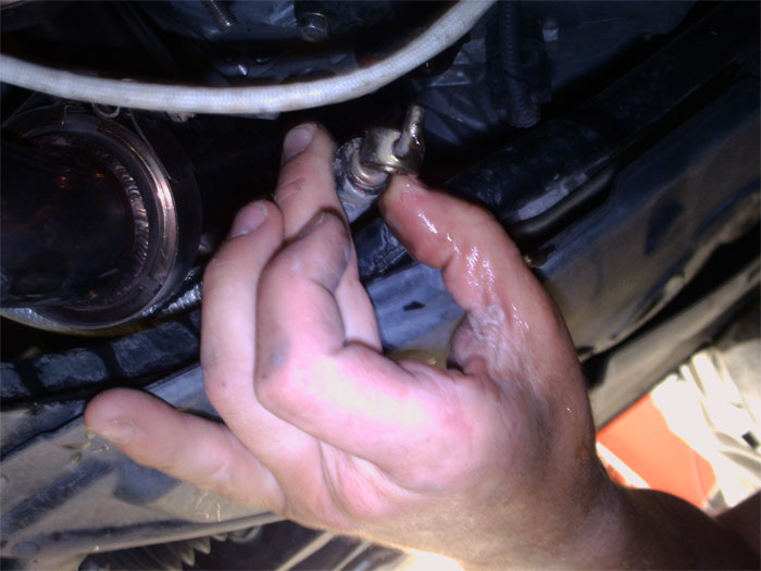

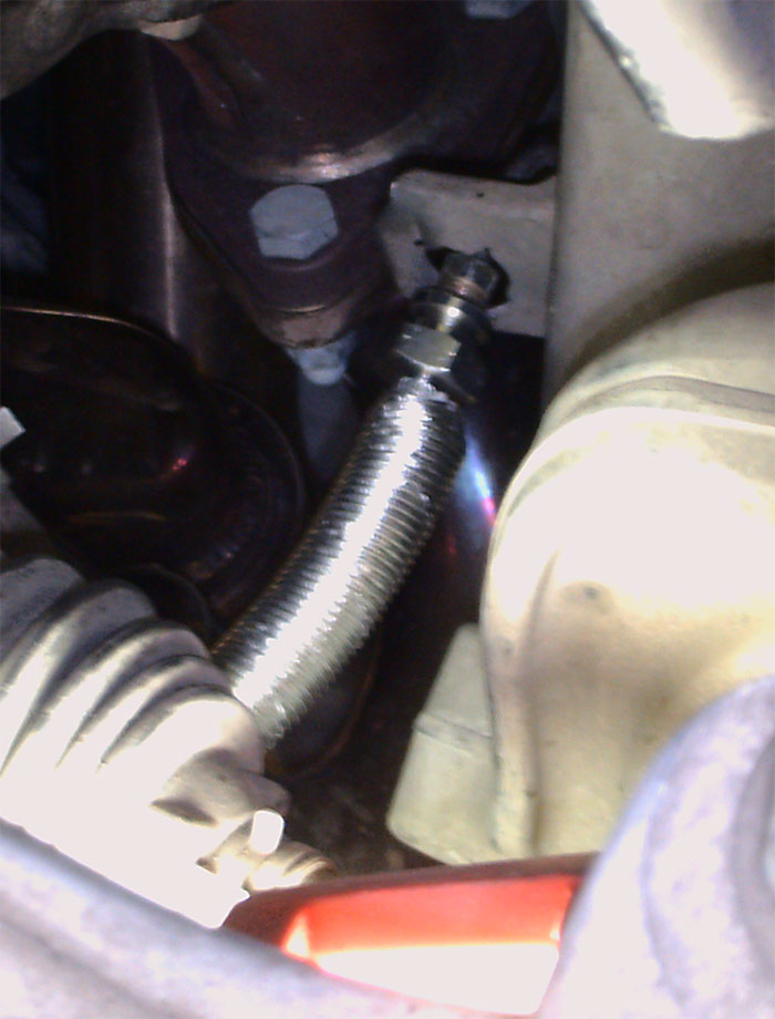

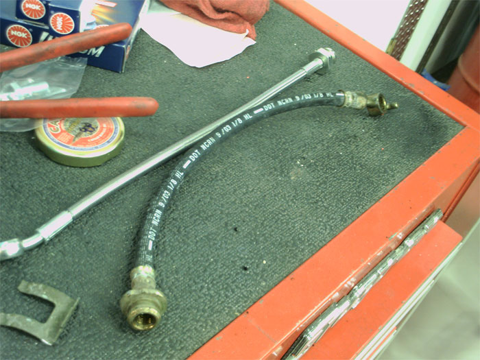

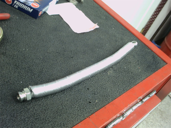

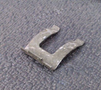

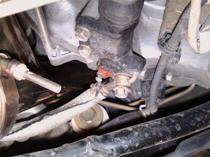

With all the heat with turbo's, from mine and Kevin's experience, I would highly recommend a stainless steel clutch line. Here's the installation we did this weekend...
Attached Thumbnails Attn SW soon to be F.I. guys...-stkline.jpg   Attn SW soon to be F.I. guys...-newvsold.jpg   Attn SW soon to be F.I. guys...-lineclip.jpg   Attn SW soon to be F.I. guys...-removeold.jpg   Attn SW soon to be F.I. guys...-oldndrain.jpg

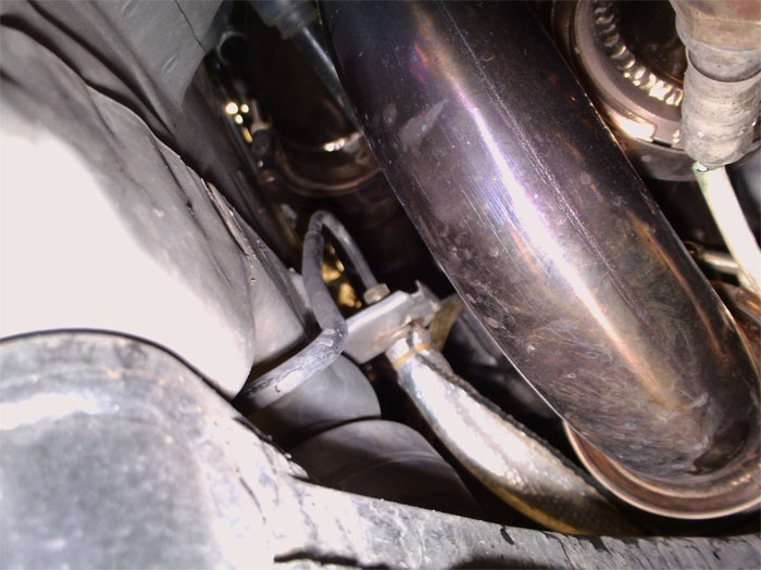

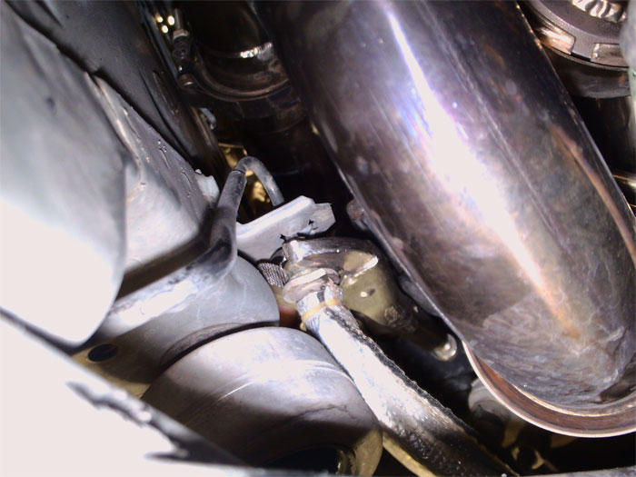

more...
Attached Thumbnails Attn SW soon to be F.I. guys...-removeclipattop.jpg   Attn SW soon to be F.I. guys...-heatsheild.jpg   Attn SW soon to be F.I. guys...-installed.jpg

How difficult was the install? How long did it take you?

No, but I had some clutch issues at PMP this weekend. It only happened after about 4-5 hot laps, and the clutch would get really soft and mushy, and once I couldn't even get it to disengage. I think the rubber line was heating up, and when it was hot, it expanded too much.

How in the heck did you get that bracket off? I can't seem to disengage the line from the bracket, or the bracket from the chasis?????
Old Aug 13, 2007 | 07:55 AM
Dave 90TT's Avatar
Dave 90TT
350Z 2+2
Posts: 1,890
From: Omaha, NE
Never mind, I got it off. What a PITA!
Old Aug 13, 2007 | 09:57 AM
hr2burn's Avatar
hr2burn
Posts: 1,476
From: Lakewood, Co
Yeah it's a slip off clamp like the brake lines have.....but you know that now!
Sorry so late
Sean
