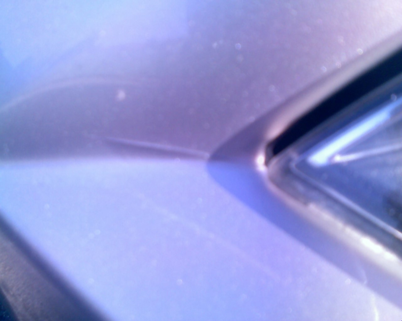

Heres a pic, little blury but in person, it looks like a black crack in the paint, starting to curl up slightly. If I stick my finger nail under it, it will just peel away. I think the nex car wash or rain is gonna result in horror.

I agree with one of the above posts, looks like they forgot an additive. from experience, looks like it started with the primer they used to prep the kit.
one of my friends had the same problem. I took him to the shop that has done all my work and literally peeled most of the paint off! You could literally see the layers of paint wich included the primer.

maybe the urethane is flexing which causes it to crack.....the shop didnt use an adhesion promoter to the rubber....and didnt use flex additive to allow the part to move without cracking.....both are the shops fault and should be covered

Yeah, Im goun there in the morning. I stopped at a shop today to get their opinion before I start *****in. They said that if it was there work they would re do it no questions asked. They also mentioned that it didnt appear to be prepped properly nor did they use flex. The shop told me they used flex too cuz I was concerned about urethane....Hes all pitchin me on the benefits of urethane and flex and a heavy clear coat, I m pi$$ed cuz even if the re do it, I still have to pay for a rental car for like a week. Then what, 6 months later it happens again, this is scary. I wish myself luck and thank you guys 0for your help.
