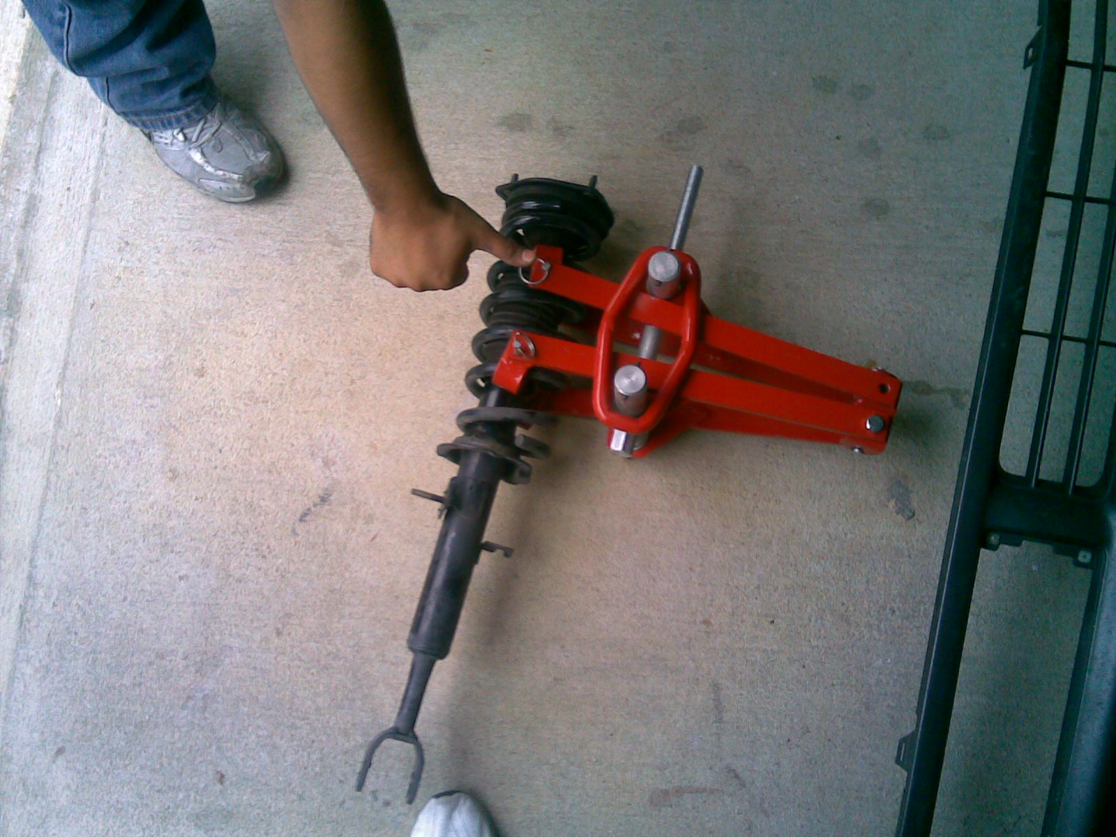

Default This Spring compressor - worth its weight in gold!
he..he... ya, i might be able to help ya out Friday, depends if im going out of town Friday or not........
but i would suggest this thing! Allstar has one and he used it on his spring install and it was soo soo simple using it for the front springs......(you only need it for the fronts)
http://www.harborfreight.com/cpi/cta...emnumber=43753
oh, and ignore that it says MacPherson struts......its just advertising that you can easily do MacPherson struts style cars with out removing everything, (ON OR OFF THE VEHICLE - see where it says that on the site)
A spring compressor is a spring compressor and it does the job just fine.....see pic below of a 350z front spring being compressed with it....(OFF THE VEHICLE - get it)
at that point in the picture, you just remove the top plate, slide out the spring with device attached.......release pressure by backing off ONE screw and then do the same thing in reverse order to put the new spring on......its actually very easy.....and depending on what after market springs you get, you wont need the spring compressor to get the aftermarkets back on, since they are shorter to accommodate the drop wanted....
so you pretty much only need the spring compressor to remove the two front oem springs.......thats it...
