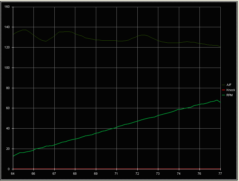

I haven't had much time to tune since I installed my Utec and Tuner Lite, but I've actually been picking up a knock (01) at around 4700 rpm with the base map. My A/F jumps a little from 4500 to 5000, but its still only 13.2-13.3, and the timing on the base map isn't very aggresive either. I don't know how accurate the stock knock sensor is, but I thinking I might just turn down the sensitivity on the Utec.
Anyone else had this issue?
Note: I'll attach a log of A/F for the base map.

Try turning the knock sensitivity down. And BTW a knock of 1 NA is nothing. Do you actually feel it driving?

[QUOTE=Ztampa]I haven't had much time to tune since I installed my Utec and Tuner Lite, but I've actually been picking up a knock (01) at around 4700 rpm with the base map. My A/F jumps a little from 4500 to 5000, but its still only 13.2-13.3, and the timing on the base map isn't very aggresive either. I don't know how accurate the stock knock sensor is, but I thinking I might just turn down the sensitivity on the Utec. [QUOTE]
Check the factory timing values in your log, if the factory timing vales continue to increase this means the factory ECU did not consider the noise knock, and you can strat decreasing the sensitivity of the UTEC knock parameter.
If the factory timing goes... 20..20.5..21..21..21.3..21.6..19..21.6..22..etc.
Because it went to "19" the factory ECU probably heard some noise it considered knowck and retarding the timing at that point.
