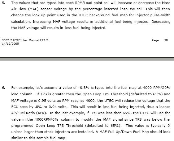

No, I am correct. I think you are confused by what I meant when I said offset. The offset is the number you are typing into each individual cell which offsets the MAF voltage that the UTEC sees and then uses to calculate the injector pulse width from its own internal background map. So your statement about the MAF signal being used only as a load indicator is not entirely true. The MAF signal + offset is used as a lookup into the UTECs internal background map. I am reading directly off page 38 and 39 of the manual. As I mentioned I know that when in open loop fueling that the ECU is not used at all to drive the injectors or the coils.

But there is no OFFSET occuring when you are in open loop fueling mode is enabled. You are SETTING the actual injector pulse widths.

I have tuned none, and I have never even used the UTEC software, however, I know how to read very well. I don't see what your problem is, but it seems as though you are attacking me while I am simply trying to get the proper information posted in this thread. The UTEC sets the injector pulse widths by using background fuel map based off the MAF voltage and the offset/percentage you put in each cell of the MAF tuning map. It's that simple. I don't know why you are so affraid of the word offset but that is how it works. Please see the attached image and read it fully:

it says that it will reduce the voltage that the computer sees and it will adjust the fuel accordingly.....
wtf!! hehehe i just know that my car runs weird sometimes with the utec open loop maf pulldown mode. i figure its the stock ecu doing something.
