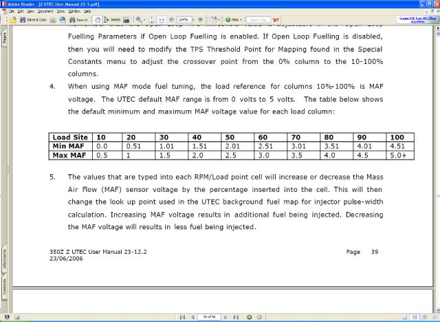

From the UTEC manual: Load site vs MAF(V)

Yes, I have found that you can change this correlation in the parameters sections, in "Specials Parameters" or something like that. I have increased the minimum amount of MAF voltage, from 0 to 2, and now the columns engages in a lower value
