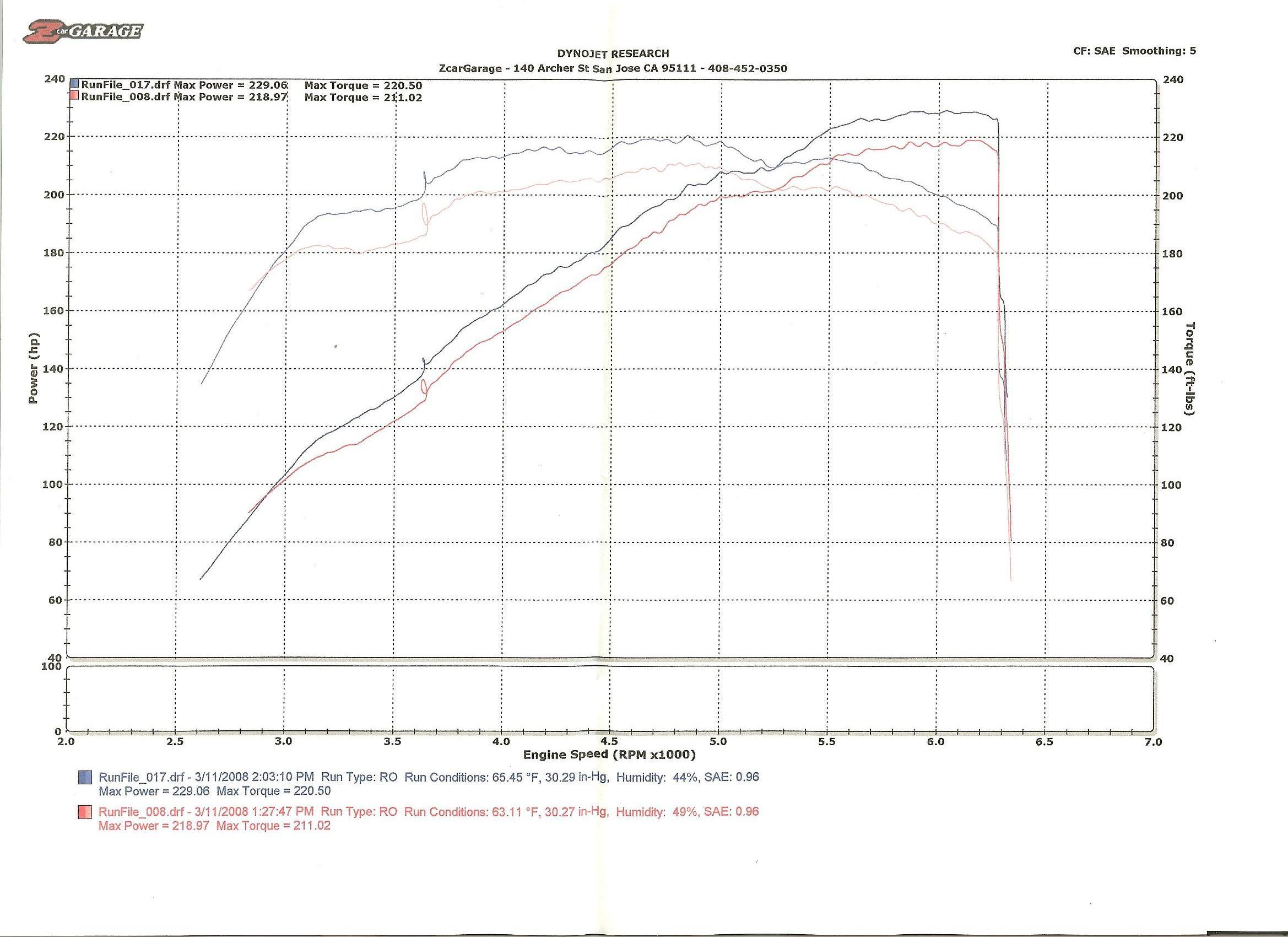

Default my dyno graph
hey all,
here's my dyno graph as promised.
Thanks

Hmmm,
overmind22 your's is kind of shaky also, but not as bad as mine.
I guess I need to get mine done again and see what happens, now that I've replaced plugs and air intake.
c3rolling's is a lot smoother.
I wonder if it is a Dyno thing?

Posts: 6,444
From: Las Vegas
^It's the smoothing the computer is set to. overmind22 is set to 5, c3rolling is 5, garym 0

Old Mar 15, 2008 | 09:14 AM
overmind22's Avatar
overmind22
Joined: Dec 2007
Posts: 23
From: SF CA
I finally had a chance to check out the gains from the unichip and the strup headers...boy, it made a huge difference around 3000 RPM...The torque seems to be much improved...
The unichip and the Strup headers netted about 11.5 horsepower as a combo...per my dyno chart from Dynojet.
We are going to install the pulstar plugs next week and see if we see any gains...
