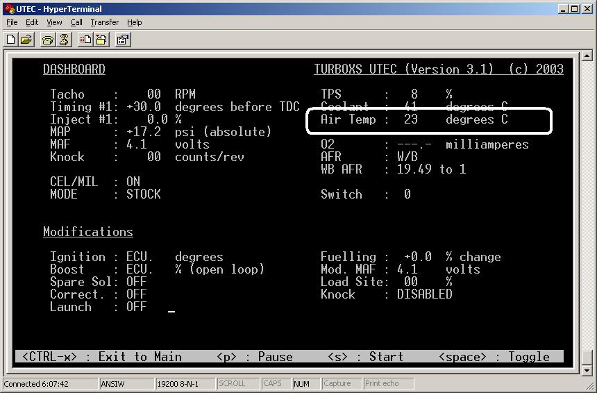

Are you sure they said that? Here's a screen shot showing IAT with UTEC.
But yeah, the Tuna Reg only adds AFRs to the total log. Tuna Pro also adds knock amplification.

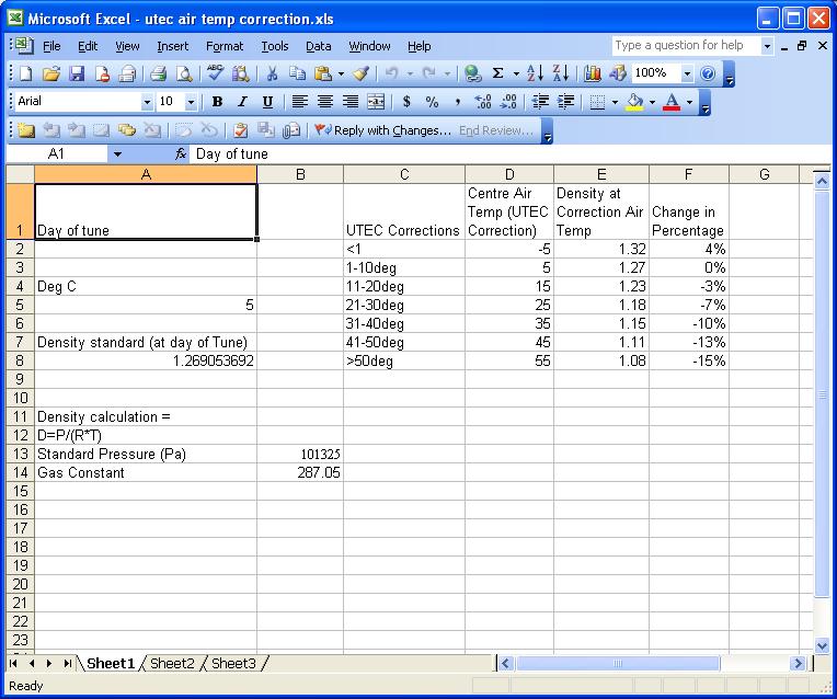

Well.... I don't think I'd call it "traditional" logging, but TXS does provide a spreadsheet template to track IATs and adjust the tune.

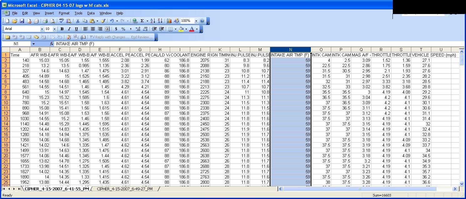

Cipher is probably the better way to go for logging IATs in a "traditional" manner. There's no lag with Cipher trying to insert external data values into a real time UTEC log, because it doesn't even know UTEC is there.
I think that's where UTI is getting hung up, but for logging IATs, UTI should be just fine since IATs don't change that much during a pull...
Of course, the downside to a Cipher log is that it isn't a UTEC/Tuner log. I pretty much just use Cipher to validate my UTEC tune, plus it came with my Orisis ECU Flash.
