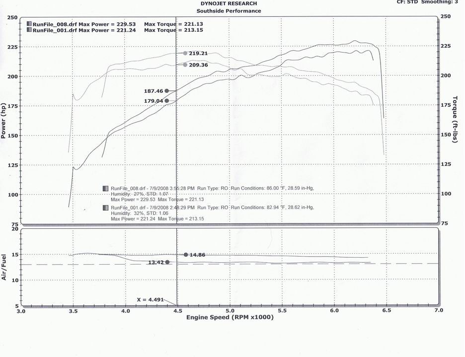

My car: 2003 G35 Sedan, Mods: 5/16 motordyne spacer, throttle body spacer, clutch fan delete, OBX Exhaust (knockoff).
Dyno done on DynoJet with tailpipe sniffer to read AFR
Tunning was done using S-AFC
Over all I'm disappointed with low gains around 8whp or so, but I guess it looked like I was a bit lean so now AFR is in much safer range.

what you guys think?

Which is the tuned AFR? I'm hoping that the 14.86 isn't a tuned AFR. Even the 13.42 is in the upper safety limits of what we'd tune for.

the 13.42 it sounds like is the new. thats not really very lean if you consider that this was with a tailsniffer and still has the cats, so its reading leaner that it probly is
not sure why youre disappointed, you made gains everywhere and you only tuned the AFR, from not being that far off to start with. you should be happy with how much you picked up throughout the powerband

so sniffer will read leaner than actual?
by how much?
so did they correct too much at tunning if im at 13.4 now?
also how r those power numbers too low or normal?

tail sniffer will always read leaner but the dyno will compensate for that. i think tail sniffer tend to read 1 point leaner especially with cat but by the time you see it on you dyno sheet, the dyno already made the correction. you are not really playing with the ignition so why do you expect to much/ you are basically just playing with the fuel right.

the dyno does not make any correction for the 02 sensor location, it's just reading the signal the sensor outputs
The SAFC absolutely alters timing because of how it alters fuel. It is rescaling the mass air, and the net result of taking fuel away means advanced timing, and adding fuel means reduced timing. This is one of the reasons, among others, why it's a less than desirable method of tuning.

so we have added up to 8% of fuel on top
how much does it take for the ecu to retard timing?

you lost at least 1, maybe 2 degrees. it depends on what cell you are starting in though, if youre on the edge you could lose a lot with a little. but i didnt realize the early 03 g ECU did that. drop in slightly larger injectors, tune the extra fuel out and get that timing back

For that kind of time and money he could just do a real tune and sell his SAFC. And he'd end up with a more reliable and better running system, with more power and better fuel economy. Plus he'd be able to see his current unit to make a few bucks.

BTW, forgot to post this earlier, but at least for my ECU its about 1 degree for every 3% removed/added so with your +8% youre looking at 2-3 degrees lost
