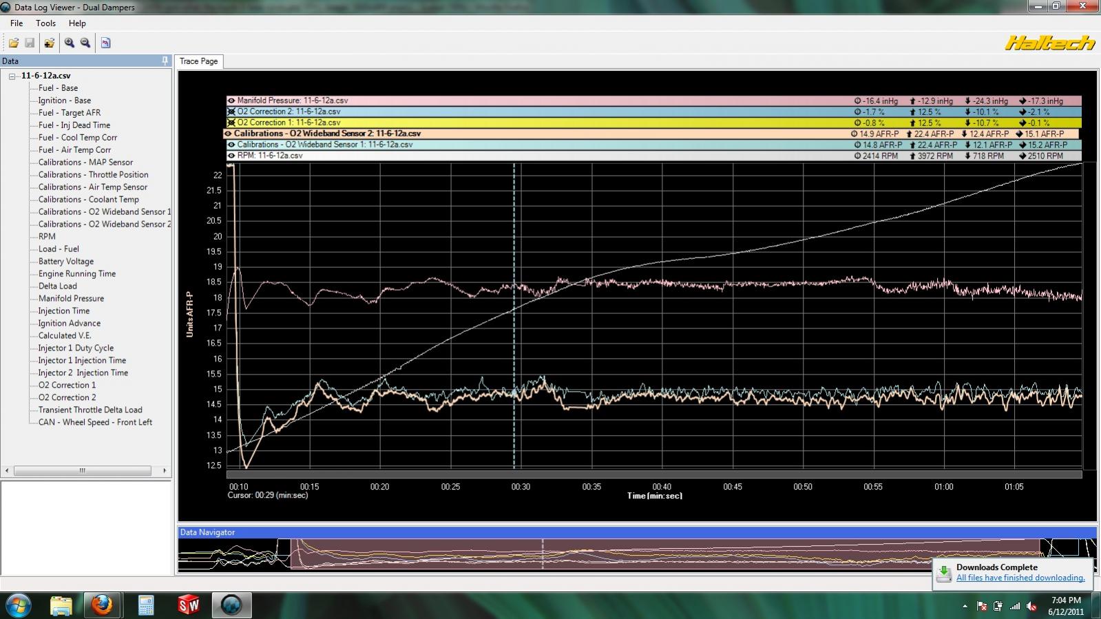

Attached is my screenshot of my data log for reference. This is with O2 correction off. I followed the steps as outlined before and from I see do not exhibit the same issue. The AF is a bit fat since i'm still breaking in the engine. it will be interesting to see if my situation changes after the fuel pump installation and swirl jet mod.

Hmm, a quick datalog like that shouldn't be too terribly large.
also, click on the a/f bar so the units on the left are a/f and not rpm. That will make it easier to see what the a/f level is as the rpms go up.

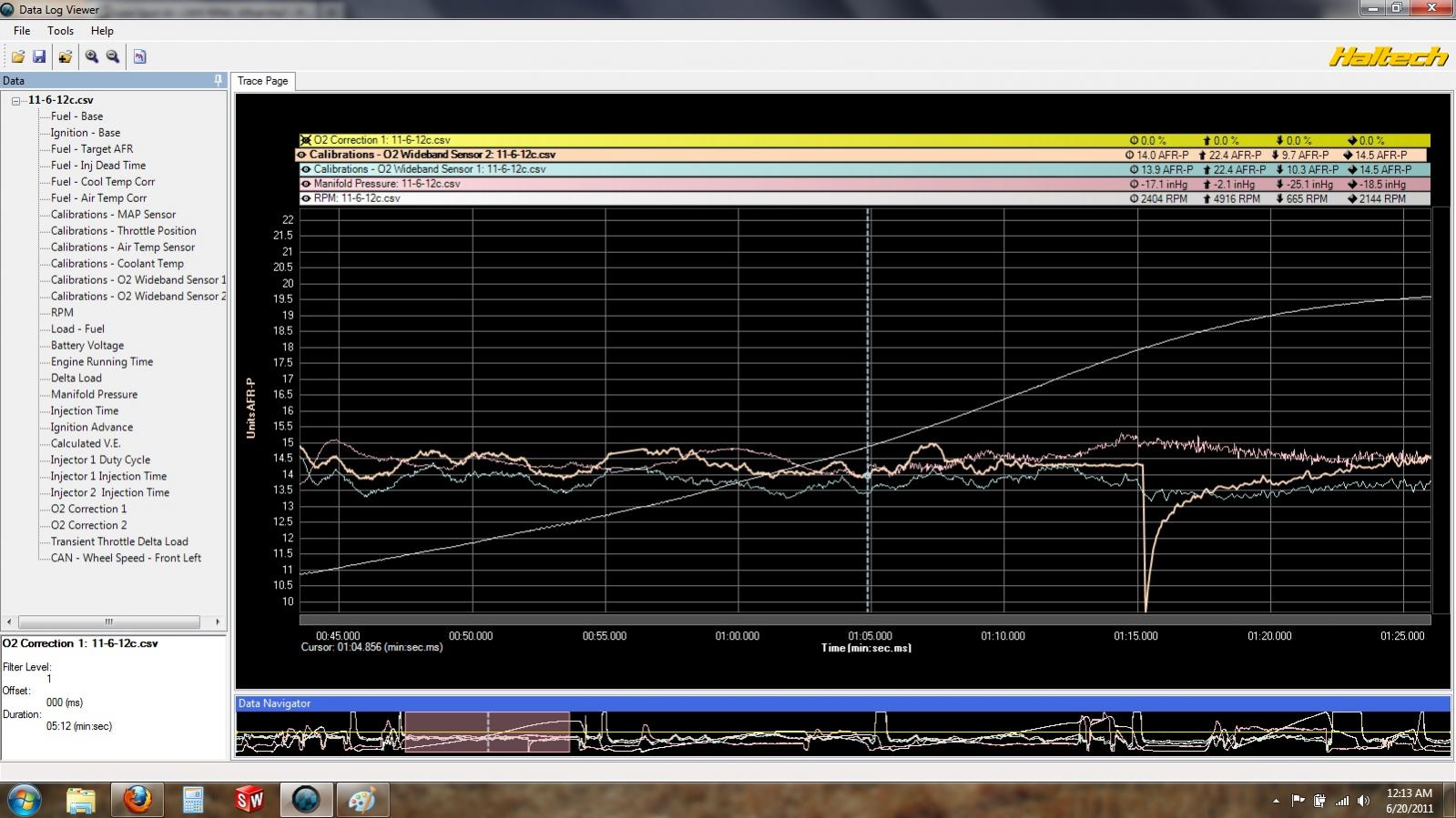

the log is 400k probably due to the number of channels logged. here it is with AF highlighted

wow, that's a pretty low a/f ratio for just a light vac cruise eh?
Old Jun 18, 2011 | 08:24 PM
  #306
MR RIZK's Avatar
MR RIZK
Posts: 1,225
From: Australia
yes it is. it was only a quick road retune when the new built engine has gone in. only done 500 miles. Point is though i do not see the spikes.

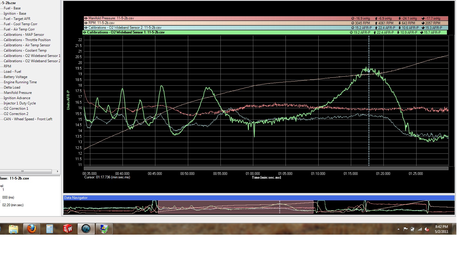

Both of those plots have O2 correction turned ON. Yes, it was that bad even with individual bank O2 correction.
Allow me to correct myself. The previously posted "2 damper" graph did actually have O2 control turned off. But I did have some logs with O2 correction turned ON - see attached for a more "apples to apples" comparison before and after the third damper was installed.
Attached Thumbnails Lean Spot At ~2400 RPM...What the?-bank-1-lean-spots-w-o2-corr.jpg   Lean Spot At ~2400 RPM...What the?-two-dampers.jpg

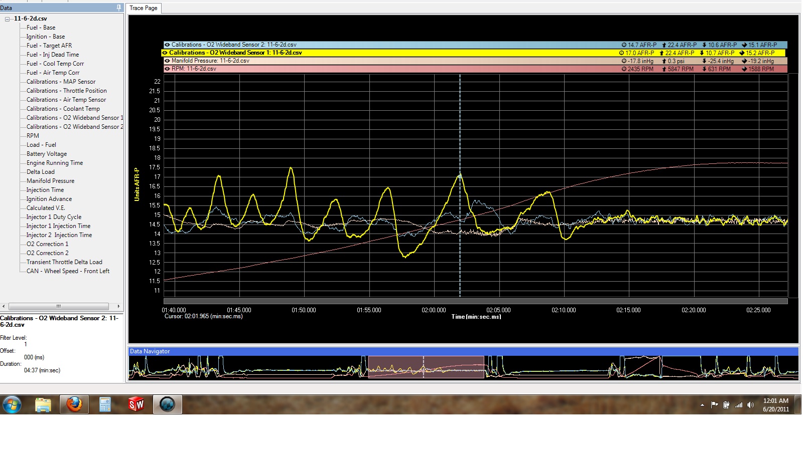

And here is an apples to apples comparison of 2 dampers vs. 3 dampers with O2 correction turned OFF.
Attached Thumbnails Lean Spot At ~2400 RPM...What the?-bank-1-lean-spots.jpg   Lean Spot At ~2400 RPM...What the?-two-dampers-no-o2-corr.jpg
