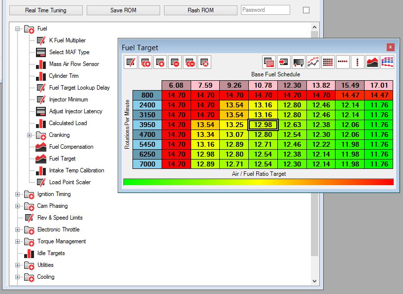

Also, need help with Fuel Target. This is how I currently set it.
Now, the problem is that according to the log file, whenever I hit WOT after 3000 rpm (both open loop conditions I guess), target AFR in log file is always lowest value in table (11,76), although tracer in ROM editors showing different, leaner, cell in Target AFR table. Since I'm N/A at the moment, I never hit more than 10-11 BFS, so target AFR shouldn't be lower than 12,54 or I'm missing something here? It's open loop and I set AFR with MAF table where I want it to be, but I'm curious why I'm getting wrong Target AFR value in my log files.

what are your AF ratios when you hit WOT past 3000. closer to 13 or closer to 12?

AF ratios are closer to 13, exactly where I want it to be. Tracer on the Fuel Target shows cell with AFR 13 too, but Target AFR in log is 11,76. So strange.

it is definitely not accel enrichment. that is based on delta TPS.
The targets can be set for whatever, but if your fuel map is way off past the 20% closed loop correction or you are open loop, then it doesnt look at that table.

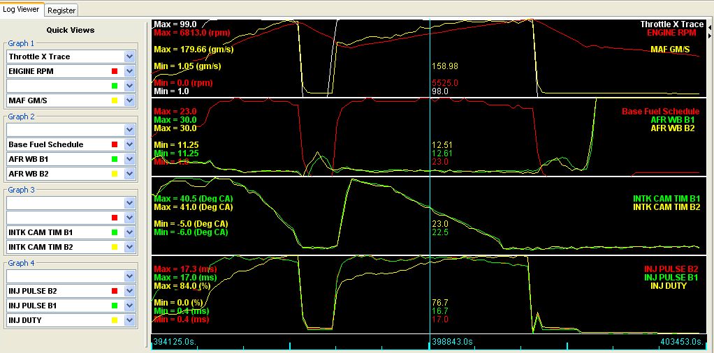

I see, thank you!
I have one more question..
Is it normal to have such a oscillation in MAF signal, as well in AFR (sometimes +-0,5)?
I'm suspecting that my MAF sensor isn't very healthy.
How did you get your view like that are you using something else to view your logs?

Used to load log files into MegaLog Viewer.
Looks normal to me.
