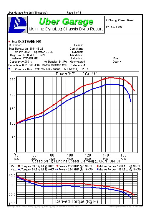

350Z HR with MINES test pipes / KNN drop in filters / Kakimoto Regu R exhaust.
All bolt on before tune is 234whp, after tuning - 257whp.
Anyone care to share if convert from rear whp to bhp is x1.25?

Looks like about a 9 percent gain in peak horsepower. Pretty impressive for all motor.

Because every dyno reads different you can't compare to stock numbers... what you should have done is what the OP did and have a before/after dyno chart on the same dyno on the same day... it's only way you can see your actual gains.

Ok From what you see from this attachment dyno do you think is a reasonable gain?

Although as others have said, it doesn't matter what the peak power is as long as you got good gains (which you did). The dyno that you used most likely just reads very low.

Only one note: the 39 and more kg/m at very low rpm are an "spike error" of the dyno...for sure !
Also on my test the dyno show a similar problem, so don't trust in that numbers.
Max torque is about 32 kg/m at 4500-5000 rpm in HR models.

+1 your car is currently one that gained the most from an uprev tune...
Can someone please explain how others are only getting a 4% gain from uprev with full bolt ons minus headers for the HR, and yet styy81 was able to get 9%? Surely those mods he had cant be that much better than the mods of other cars that got uprev tunes...

Nice gain in hp! 9.8%

IMHO is a little too much gain...
But BETTER for him !

This looks about right. I had a base of somewhere around 244rwhp, then added mods in my sig and it dyno'd at 274rwhp...then after tune at 292rwhp on a close to a 100 degree day. I like that, but was more satisfied with how the car drove all around so much better. Loved the gain in throttle response!
