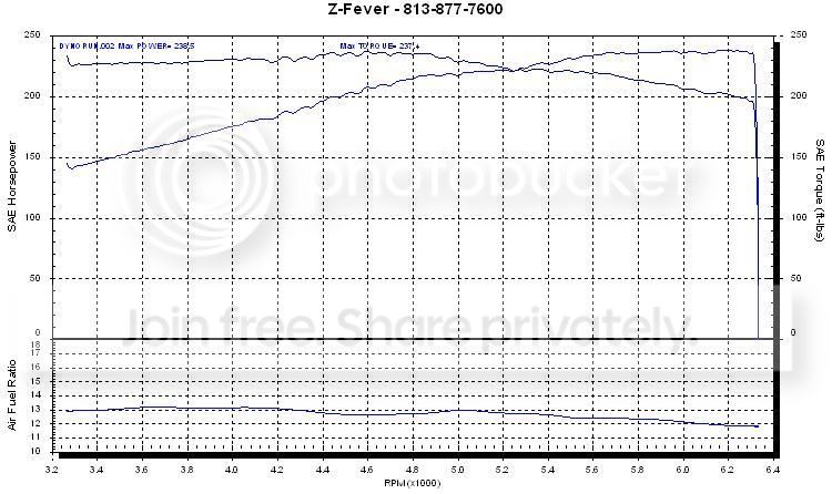

here is a baseline I fould on another forum for a de with the AFR. You can see its 13 is about the highest it goes.

joepro was tuned at R/T Tuning in Lansdale, PA. He used that Z-Fever map to show djamps an example of A/F.
