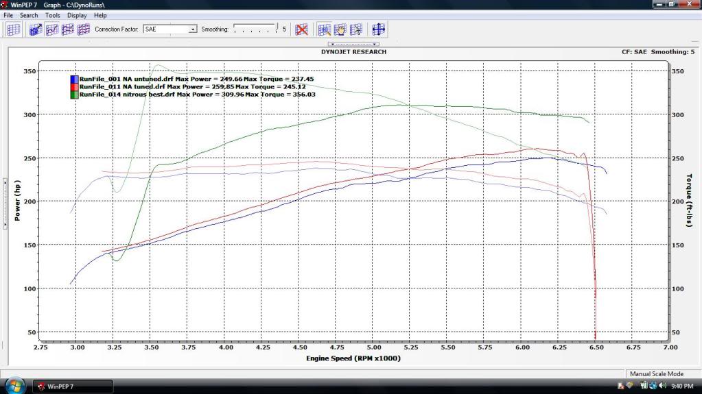

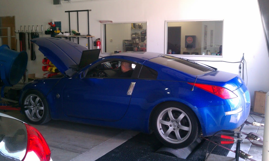

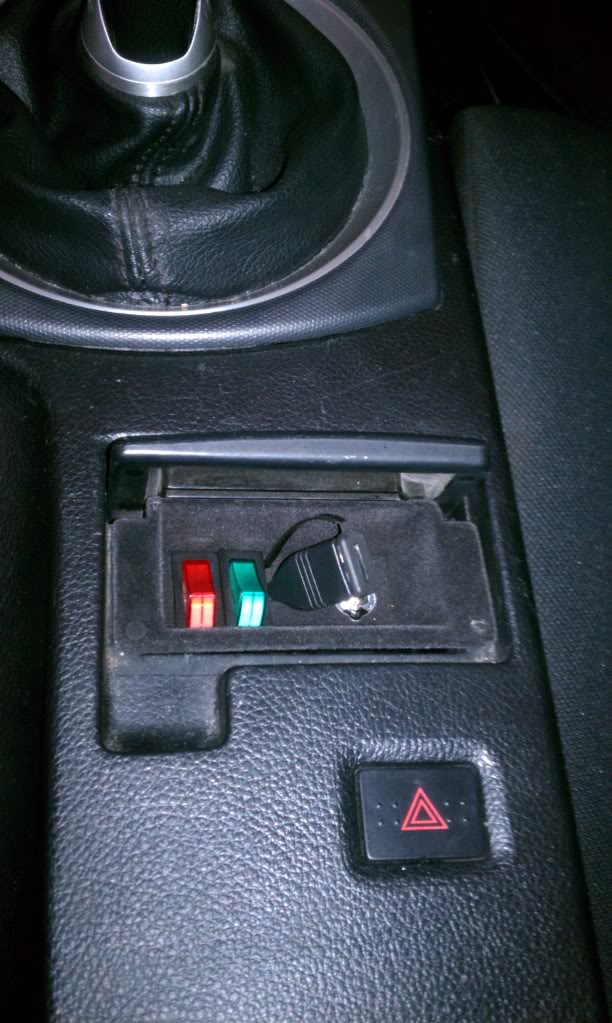

Last week I took my Z down to the guys at Uprev in Austin to get tuned. After a long battle getting my nitrous setup installed properly (see: https://my350z.com/forum/nitrous-oxi...-solenoid.html ) I was confident that it would put down some decent numbers and I was not disappointed.
260whp/245wtq NA after tuning, with gains realized throughout the entire powerband. Even better were the numbers on the bottle: 310whp/356wtq! Here is a list of my mods:

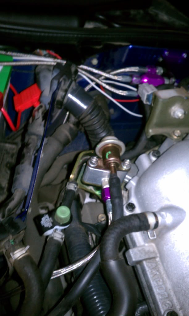

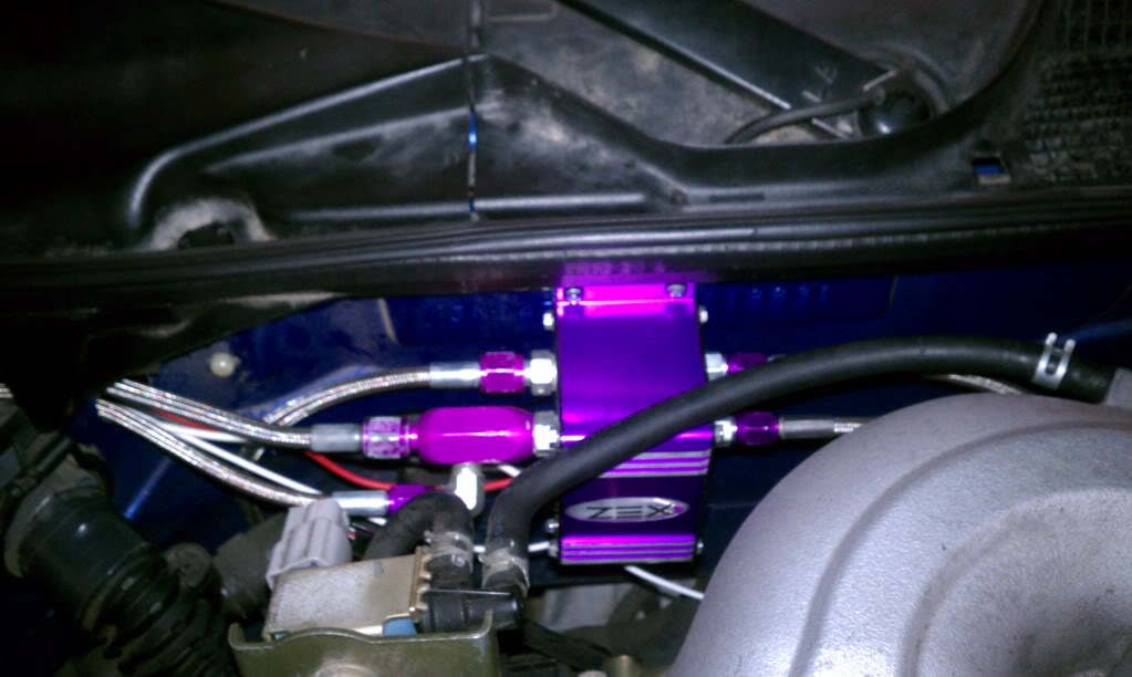

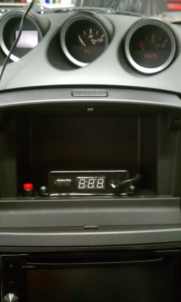

Zex 75 shot wet kit (with automatic bottle warmer @1000psi, zex window switch, purge, and NGK 1 step colder plugs)
JWT Pop Charger
Motordyne 5/16" plenum spacer
Motordyne ART pipes
HR Y-pipe
STOCK midpipe and muffler
Uprev tune
Below is a dyno graph showing baseline, tuned NA, and nitrous runs. We tuned the throttle tip-in to alleviate the lean condition and associated power loss upon nitrous activation and ended up enriching the AFR to 11.7, so the final nitrous numbers were slightly lower, but much safer.

I love the sound that the ART pipes give me with the stock muffler, and don't want something too loud. I considered a Stillen TD system, but for the price I think I'll sacrifice the ~5whp it would give me. Obviously considering my results vs. others who have full exhausts, the stock midpipe and muffler are not that restrictive.

Also, for those who may be wondering, all runs were conducted in 4th gear.

good numbers overall. never seen anyone tune a nitrous car so lean. the richer the better for no2. ask your tuner to get it back on the dyno and tune it for 10.8 to 11.0 at least.
