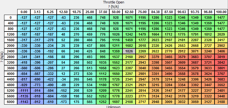

Bumping this as I have scoured the depths of the internet and I honestly couldnt find much on throttle change maps for de vehicles that are A/T.
Is anyone getting an error at all with these changes? I dont own a 350z however we do share the same part number for the throttle body. I am getting e0605 error code. However it isnt all the time its intermittent and i basically lose all throttle until i clear the code and wait a while.
Has anyone had anything similar happen?
Never got an error, but my car is manual transmission.
Double check the trottle maps and maybe go back to stock to see if problem arises the same...

Ok changed the throttle map back to stock
less p0605 errors but still occurring
the only other maps edited currently are torque management, intake cam timing map and load base fuel schedule.

Ok sorted the errors and trying to work through some throttle maps.
I dont own a 350z but have the same throttle bodypart number from nissan attached. Is my standard map.
I tried to use the 350z table that was posted here, however, the throttle wouldn't open fully.
Has anyone figured out more on how this table works?

you understand how the electronic throttle works yeah and it has nothing to do with where your foot is as it changes depending on rpm.
