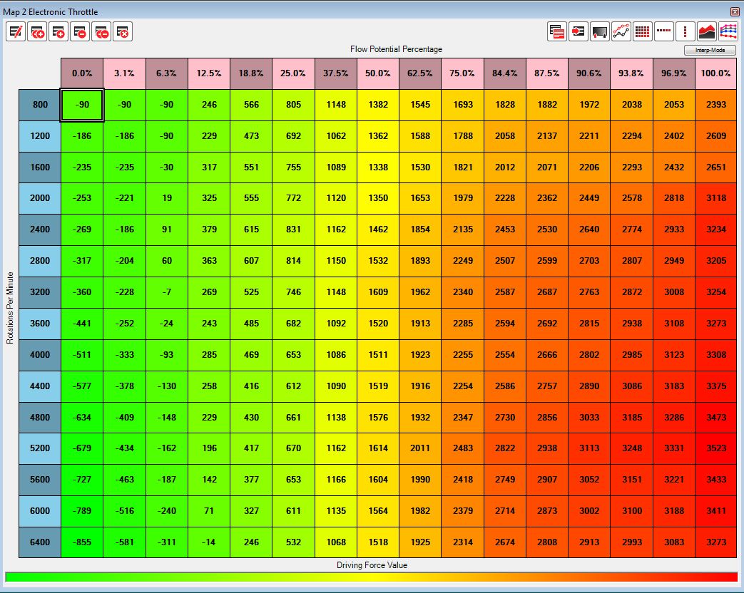

First try using the same "algoritm" but using max value of 3700 and medium of 2200 for "security" reasons...
350HR is very similar to 370 but just to be sure on first attempt i stay lower...
These are two pics of original values and smoothed ones...

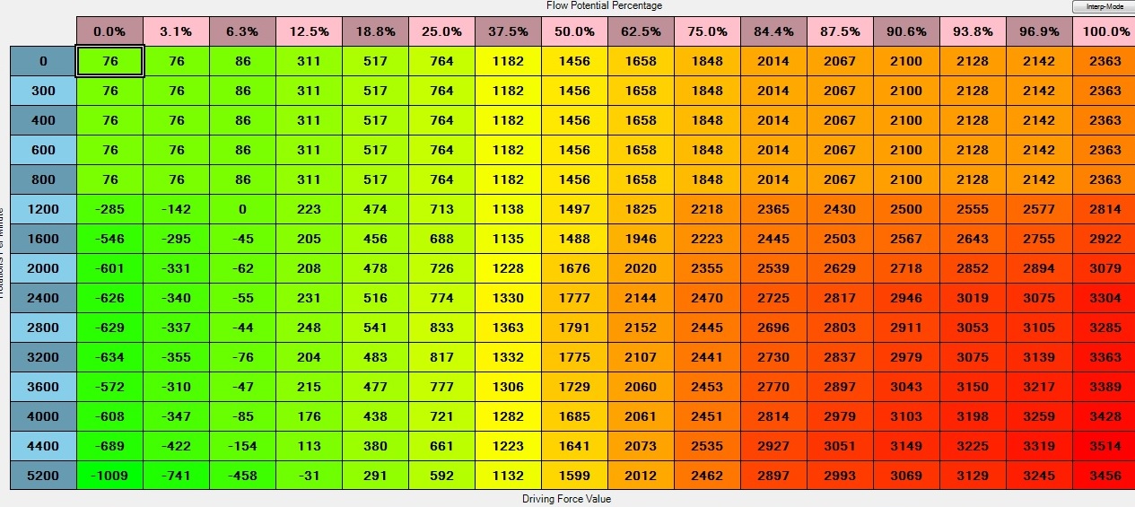

cthrulies's Avatar
cthrulies
Joined: Oct 2010
Posts: 4
From: Houston
Default "revised" uprev throttle map
Djamps, I was working on a new throttle map a while back. Since I have an automatic DE as well I was trying to "sync" my throttle map with the torque management map to get a better performance. I based my "revised" throttle map on the Uprev throttle map (the one you select in Osiris tuner). I noticed that a lot of dyno graphs had the most torque at 2500 rpm, 3250 rpm, 3850 rpm, 4500 rpm and 4800 rpm so I tried to mirror that in the throttle map. Its not perfect and still needs some tweaking but is an improvement on the low end -at least it feels that way to my butt dyno. Feel free to try it out. thanks.
Attached Thumbnails Uprev smooth throttle curve-revised-uprev-throttle-map-compressed-.jpg

I used a polynomial function of second order to obtain this values, starting with base values :
- STOCK values at 0%
- FIXED value (2200) at 50%
- FIXED value (3700) at 100%
The function is same like y=a*x^2+b*x+c
So in my table are 15 DIFFERENT functions (little but different!)
For every different rpm i derived the correct parameters (a,b,c) using these 3 numbers then "predicted" the others using function found and making an Excel table. X values are the known % flow, Y the NUMBER to be found.
Looks mathematical complicated but it's not so hard (afret some days for understanding)
If someone need i have one free software to do the most difficult thing (find the correct function to interpolate the 3 fixed number for every rpm), with this you can the use Excel and find all numbers.
Free software used is "Polynomial Curve Fit Program", POLYFIT.
Thanks to author !
Is the same way used by 370 owner of forum i wrote up, i only change little fixed values in a more "safe"way.
Still need to test the car for now !

Today fist try of new map.
I can speak about defect in low speed running, city running and similar : i found NONE !
Two hours of run at low speed, in all gears, also with A/C on just to try: all simply perfect, no sputtering or strange behaviour.
Tried 2 or 3 WOT in 1-2 gear and car seems more "wild", ESP goes in very fast.
If you wanna try difference and enjoy full the power you have to take off ESP, i suspect that "stock" map is made in way to "accomodate" with ESP and avoid too much interaction. Forcing more opening of throttle cause more ESP showing.
Tried also a couple of WOT in 3 gear until 8000rpm, no problem at all.
I think that the difference is not big but someone more "sensible" of me in running can feel it for sure.
Anyway if someone want to try now i'm quite sure that mod is not "dangerous", every hopinion is very well accepted.

i made an excel program using linest where you just put in the stock 0% values and then you desired 50% and 100% values.
That way you can quickly make any number of throttle maps you want based on 2nd order poly regression
This is my stock throttle map, as you can see its different than the other ones posted. Thats why its might be imprtant for you to create your own maops based on your own ROM files
