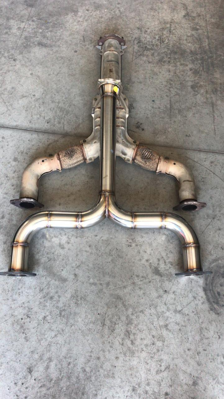

Hi guys. Last week I dropped my car off with a bunch of boxes I’ve been accumulating, mostly bought here from the forum. They installed a plenum spacer, some APS high flow cats, an APS 2.5” cat back exhaust that was modified for turbo use by fabricating a great looking Y pipe, and a full Nismo intake that already came with the car. A bizarre note, I know I had ordered the 5/16 plenum spacer but they said they had to modify the strut bar to fit it, so that makes me think I received a 5/8, but anyway it’s installed.

Seems way low....y pipe is lacking imho
In design, or what do you mean?

Welds may be nice, but by eyeball, I'm guessing that the volumetric flow rate will be reduced with this ypipe.

They installed everything and then actually tuned it. I think he said they were on the machine a good 5 hours or so.
I get what you mean on the y pipe. Originally I had walked in the shop wanting a dual set up, but he said there’s usually noticeable torque loss down low that’s difficult if not impossible to tune out. So he recommended a y pipe.
in design... isn't much better than than the stock one in my opinion. here is the stock de vs stock hr y pipe

Yea I’ve read lots of y pipe threads, and you may be right. I could throw a Motordyne in there someday. I imagine even as it stands the new one must flow better than the stock crap.
So basically my reason for posting was to get feedback, so I appreciate that. I’m wondering if the 37-39 gains were about on par for what I did? As that’s what’s most important, not necessarily the numbers themselves.

the Y-pipe looks very nice and sure there may be some inefficiencies with the 90s but it's not the reason youre down 40 additional HP...
