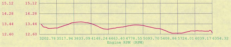

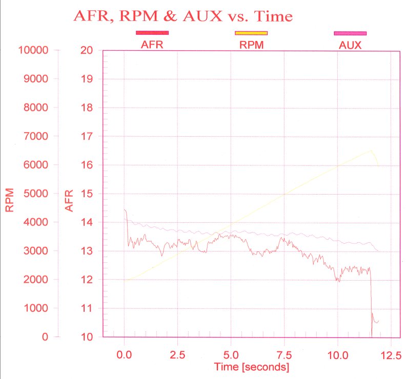

Hi Zboater. If you took out the factory O2 sensor and plugged in a wideband O2 for the run, I would have to throw out your A/F readings. When you take out the O2 and leave it hanging, the computer is going to richen up the car by a lot. If you disconnect the O2, it will go to default and run richer than normal and cause the CEL to come on too.
Old Dec 13, 2004 | 10:43 AM
  #129
ZBoater's Avatar
ZBoater
Posts: 743
From: Tampa, Florida
Well, I have to assume the guy knew what he was doing, and that was on one of the dynos. The other dyno used the tailpipe sensor, and the readings where similar.
Here is the link for the dyno that used the O2 sensor:
http://www.quiros.net/350z/dynos/100804AF.jpg
And here is the link for the other dyno, the one that used the tailpipe sensor:
http://www.quiros.net/350z/dynos/100904AF.jpg
With the two of them being so close to each other, I have no reason to doubt where my A/F is at this point. Also, the CEL light never came on in either case.
I am just trying to understand so I can make an informed decision. Any feedback or suggestions will be appreciated.
Thanks!!!

I'm trying to understand the first A/F reading. It looks like the guy held the throttle at around 4K rpm for 11 seconds to read the A/F?
Yeah, that graph is weird. No, the rpm is the yellow line (very faint) and is a straight diagonal line going up. The AF is the red line which fluctuates between 13.5 and 12.5. The aux line doesnt mean anything, it was some other measurement that wasnt used. What makes it weird is that both AF and RPM are on the left column (y axis), but the yellow line is meant to indicate a steady progression up the RPM range and the red line is the AF throughout that range.

Ah, gotcha. Talk about faint. I didn't even see the yellow line till you mentioned it!
