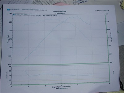

Here is my recent dyno run after the TS Reflash...
I guess i'm going to have to send it back for the 3rd time..

That's just outrageous. WHEN WILL THEIR BE A GREAT SOLUTION????
